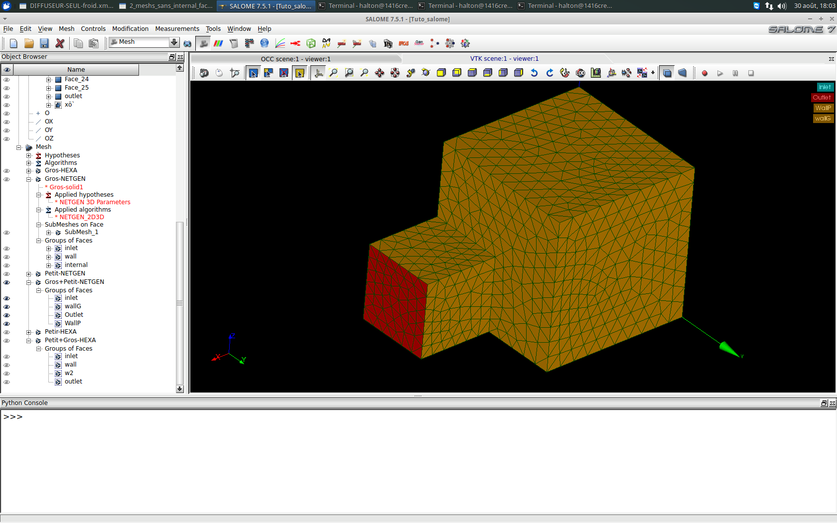

During a simulation of a air diffuser in a room, I have stranges velocities.
I have already change mesh parameters and time step parameters, but I would like to know how can I check what is wrong ?
In the listing file the Courant Number is correct and residual part too.
About the Fourier Number or the rate (Nb Courant / Nb Fourier) what is the correct value for that ?
(I have cut the listing file to lighten it)
Thanks for your help.

Did you try to reduce the Courant Number to get a Co~1..5?.
Looking at the figure that you posted, I think that you can do a structured mesh using 3D extrusion, doing a mesh for the diffuser, a mesh for the room and then gluing at the interface.

Hello Luciano,
This is a good remark, I have changed the meshing netgen 3D-2D-1D for the diffuser and hexahedric (hexahedron i,j,k) mesh for the room and assembled it together, I think this is the best way, but the junction is bad and my simulation diverge (conjugate gradient).
I would like to know, if there is a step in Salome to improve the connection between the two meshs ?
Best regards
Claude

Hello Claude,
What do you refer with "the junction is bad"? Are you doing the face joining in salome (build compound->merge coincident nodes and elements) or in CS (Face joining)??
I don't know how is your geometry, but you can use projection 1D2D in Salome in order to have the same mesh at the interface between both mesh. Also, you have to check in the CS listing the joining information in order to know if all the face were joined.
Luciano
Luciano

I tried to do the meshs junction properly with a simple case between 2 cubes.
Firstly, I tried with hexa meshs, and it's work correctly, when I make the junction in C_S or in Salome (build compound).
Now, I'm trying to make the same thing but with complex meshs (NETGEN).
I have successfully made the meshing junction (conformal mesh) thanks to the function projection 1D2D with a sub mesh.
After that, when I am "checking the mesh" in C_S, I have the following mistake "bad connectivity for the cells" (see attached file in French), with a mesh junction in Salome.
I also tried with two meshs with the junction in C_S, but I have also a mistake, with the error in the listing file (attached) : "420 faces have a null distance between centers, For these faces, the weight is set to 0.5"
Thank you for your help.
