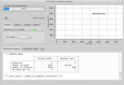

Hello everyone,
I am trying to get used to Code_Saturne and Syrthes and I wanted to do the tutorial called "3disks2d".
The first part concerns a computation with Syrthes alone and this is where I have a problem.
Actually, the setting of the computation goes well but when I launch the simulation, it is stuck at 14% at "Conduction Initialization" (see joined file).
Does someone know what is wrong? Is that a common problem?
Thank you all for your help.
Clément

Re: Tutorial about the coupling simulation with SYRTHES
I have the exact same problem.
In listing file:
In console output:
Any idea how to get more verbose output in order to diagnose this seg fault?

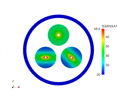

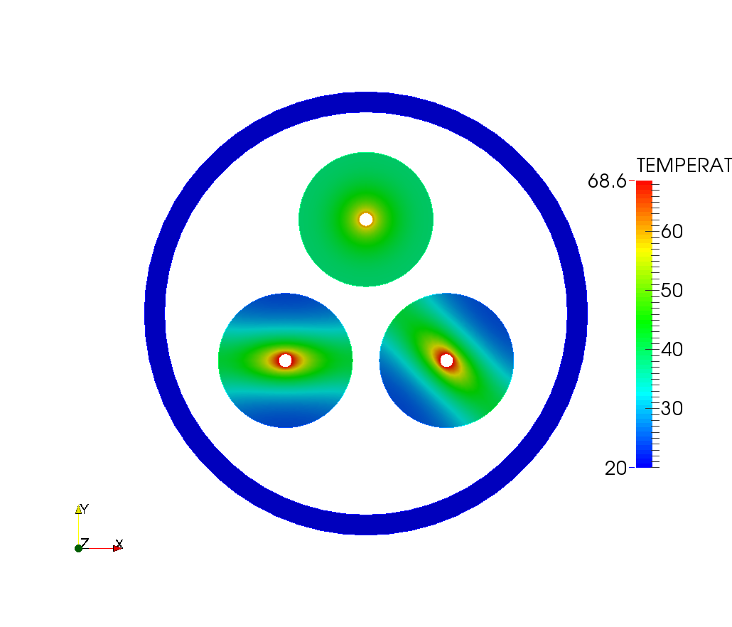

I've used the files that you have uploaded to set up your case on my machine. However, it doesn't run for which reasons it is not clear. So, I set up a new case using the mesh that you supplied. This runs okay and gives results of the temperature distribution in the three discs. The attached file contains the run on my machine which is using Syrthes V4.1 and Ubuntu 13.04.
Can you please try this case on your machine and let me know what happens.
Brian Angel.
Brian Angel.

Hello:
I ran the syrthes.gui command opened the file you provided and started the run. The progress bar stops at 14% as shown in Clement's screenshot.
I killed the run and closed the gui. I ran the command line which was echo'd from the gui run:
Here was the output:
Is there a way to compile syrthes with debug on to see where the crash occurs?
Thanks
Stefan
./syrthes.py -n 1 -d Test_renuda.syd -v ensight -l listing_syrthes
