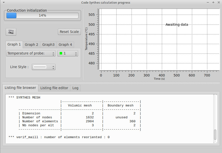

I am trying to get used to Code_Saturne and Syrthes and I wanted to do the tutorial called "3disks2d".
The first part concerns a computation with Syrthes alone and this is where I have a problem.
Actually, the setting of the computation goes well but when I launch the simulation, it is stuck at 14% at "Conduction Initialization" (see joined file).
Does someone know what is wrong? Is that a common problem?
Thank you all for your help.
Clément

Re: Tutorial about the coupling simulation with SYRTHES
I have the exact same problem.
In listing file:
In console output:
Any idea how to get more verbose output in order to diagnose this seg fault?
Thanks,
Stefan
In listing file:
*** SYRTHES MESH
| Volumic mesh | Boundary mesh |
| Dimension | 2 | 2 |
| Number of nodes | 1632 | unused |
| Number of elements | 2904 | 360 |
| Nb nodes per elt | 3 | 2 |
*** verif_maill : number of elements reoriented : 0Code: Select all
Start SYRTHES preprocessing
Updating the mesh file name..
-> OK
Start SYRTHES computation
Execution of SYRTHES..
-> number of processors for conduction = 1
Segmentation fault (core dumped)Any idea how to get more verbose output in order to diagnose this seg fault?
Thanks,
Stefan
Hello:
I ran the syrthes.gui command opened the file you provided and started the run. The progress bar stops at 14% as shown in Clement's screenshot.
I killed the run and closed the gui. I ran the command line which was echo'd from the gui run:
Here was the output:
Is there a way to compile syrthes with debug on to see where the crash occurs?
Thanks
Stefan
./syrthes.py -n 1 -d Test_renuda.syd -v ensight -l listing_syrthesHere was the output:
