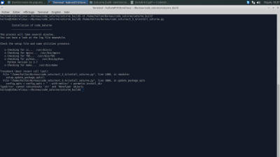

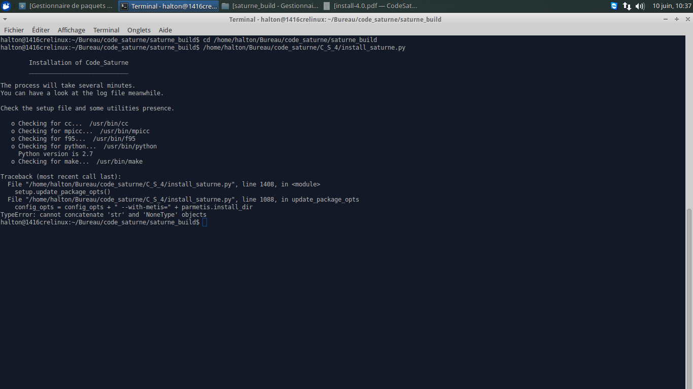

Please post a real screen capture (you can cut/paste messages) instead of an photo with glare.

Sorry, this is the real screenshot in the atteched file...
Regards
Claude
Regards
Claude

What is in your setup file ?

I'll try to reproduce this and fix it, but you can probably work around the issue by not setting parmetis to auto in the setup file (either set yes with path, or no).

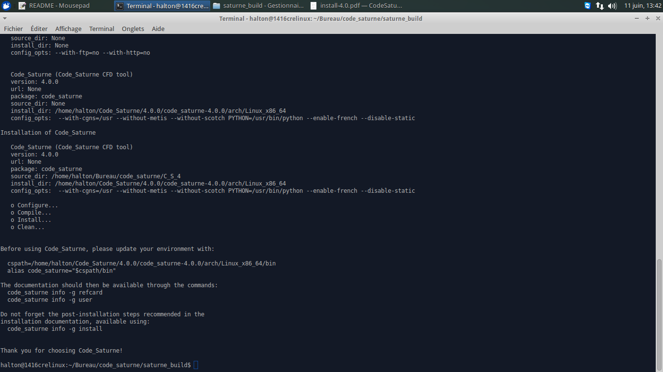

I have modified the setup file, after some tests, I put "no" for Metis and Scotch.
I think that's Ok. I must again do the "post-installation"...

Hello Yvan, it's again me ...
I have just finished the post-installation, but it's clear that Code_Saturne is not installed,
How, can I know what is wrong ?
I would like to know, if there is normal, if I have 4 main directories ?

I know the code is installed ("Thank you for choosing Code Saturne" after that I have re-run the setup file for the automatic installation),
moreover the file "code_saturne.py" was created in the install directory.
Now, the post-install is necessary.
I copied the file code_saturne.cfg.template and I know, I must modify and uncomment (by removing "#" ?) the file "code_saturne.cfg".
