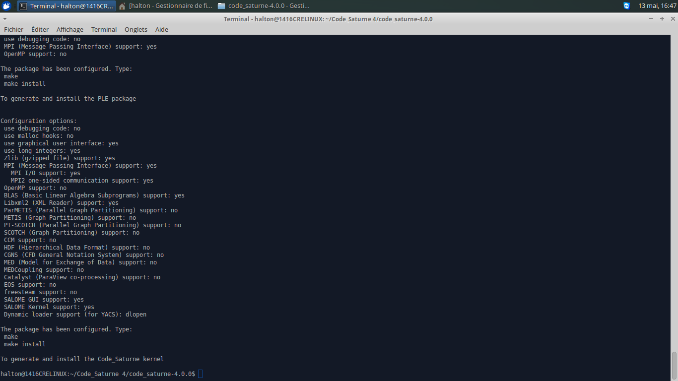

I have seen during the step "./configure" that for the configuration options :
HDF5 support : no
CGNS support : no
MED support : no
Whereas, I have already downloaded in the Synaptic packet manager, the packets :
HDF5 (hdf5-tools v1.8.11-5ubuntu7), CGNS (4 files : cgns-convert ; libcgns3.1-dbg ; libcgns-dev ; libcgns3.1 Version : 3.1.4.2-1) ; and MED (libmed-tools v3.0.6-2ubuntu1)

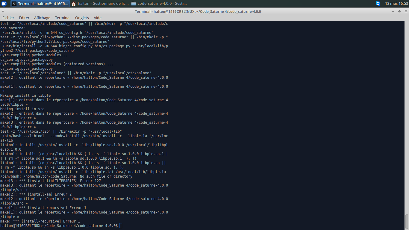

Moreover, I have some mistakes after "sudo make install" :
***[install-libLTLIBRAIRIES] Erreur 127
***[install-am] Erreur 2
***[install-recursive] Erreur 1
You can see in the attached files the text in the shell after "./configure" ; "sudo make install" and file config2. (log file).

Posts: 4289
Re: Installation C_S v4.0
You seem to be missing some "dev" packages, and should not run configure from the source directory.
All those recommendations are explained in the first few sections of the installation manual, which is with the sources, and also on this website.

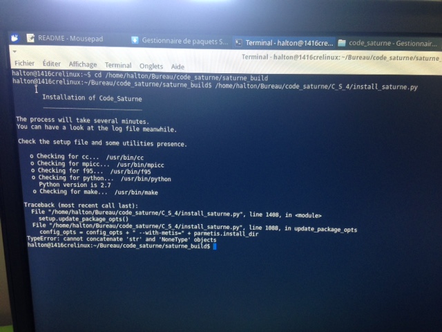

thanks, I have successfully run for the first time the script in a separate directory.
I configured the "setup" file and run the script a second time.
you can see in the attached file the screenshot from my shell.
an error occur : TypeError : cannot concatenate 'str' and 'noneType' objects
for information the file : "install_saturne.log" is empty,
and I have also check for cc, mpi, f95, python and make in usr/bin and all is OK.
and the install directory was created but also empty.
Thank you for your help
