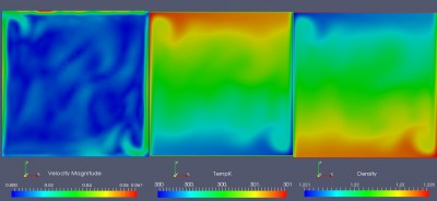

I attach an example of the heat transfer in a square cavity, it can be helpful
Regards.

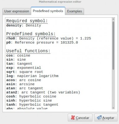

But unfortunately, the temperature does not appear amid the predefined symbols for that MEI expression, so this would not currently work (I consider this a GUI/data input bug, and we need to fix it).

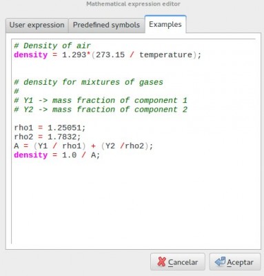

In the predefined symbols the temperature doesn't appear, but is used in the example tab at least in CS 4.0. In the example that I have posted I only use the GUI and it seems to works.
