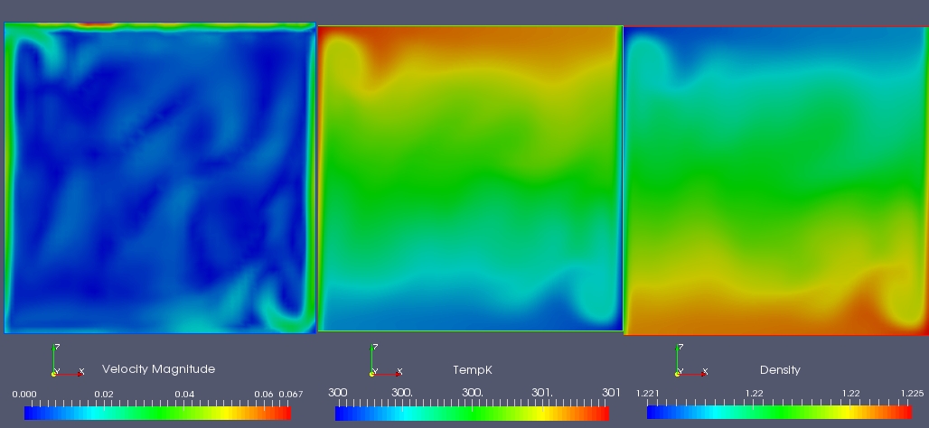

I attach an example of the heat transfer in a square cavity, it can be helpful
Regards.

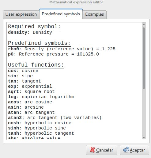

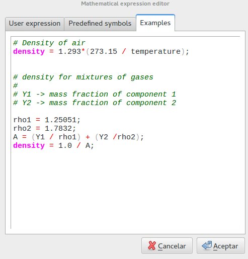

In the predefined symbols the temperature doesn't appear, but is used in the example tab at least in CS 4.0. In the example that I have posted I only use the GUI and it seems to works.
Additionally, you mention that the density is a constant, but you are using an expansion coefficient, so the density will change with the temperature. Please excuse me if I am not understanding your question.
