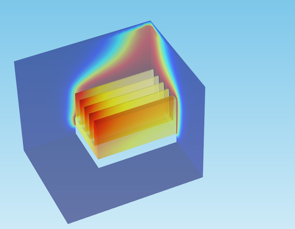

To get an idea of what I'm trying to do, look at the picture I attached. This comes from a COMSOL-Simulation.
