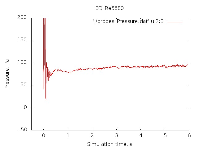

I have spurious peaks in 'pressure time profile' at a monitoring point in 2D configuration. I do not observe these spikes in 3D simulation.
The simulation I am carrying out is a flow in an array of cylinders. It is at Re=5680 using LES. I do have checked with V2F turbulence model in 2D configuration as well, I still observe the spikes.

Your computation blows up from the first iterations... Your mesh seems to be not refined enough.
