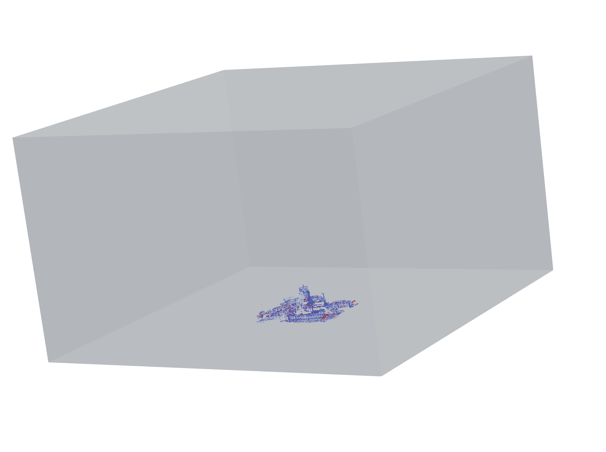

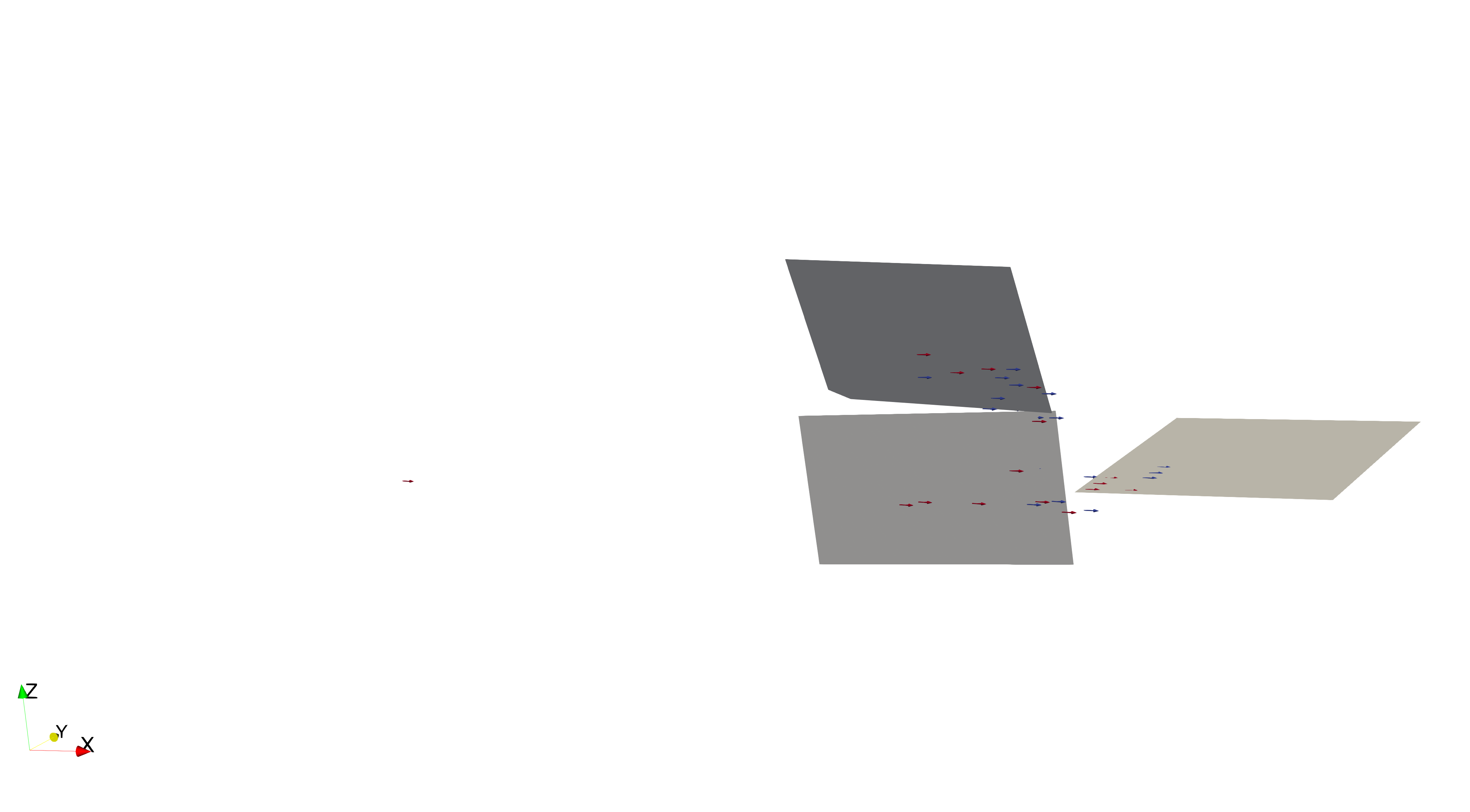

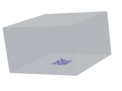

The results include two new case files: MESH_00.case and IB_MESH.case, the purpose of which I do not fully understand. In addition, in the RESULTS_FLUID_DOMAIN.case, there are several new variables such as porosity, porosity_holes, and nb_scan_points. The porosity-related results appear unusual, and their spatial distribution does not resemble the building geometry. Is this behavior expected?
Could you please help me to check if the study is right? I have attached the run_solver.log. and my domain setting.
Thanks again for your guidance!
Best
Sophie

The MESH_00.case and IB_MESH.case should help you visualize whether the immersed boundary is where you expect it. Actually, in the master branch (since revision fa9358ab, last friday), you can also visualize the faces where cells are cut, by calling;
cs_porous_model_enable_post();
in cs_user_parameters.cpp.
Porosity should be 1 in fluid areas, 0 in solid areas, and have intermediate values in cut cells. Does it seem OK when you visualize it ?
I know that on complex cases, when insufficient data (i.e. scanned points) is present to build a mean plane intersecting some cells, some badly oriented cut planes can occur, an need additional filtering, though I am not quite sure how this is done. I can check with the colleagues developing this.

I see that your point cloud (the .pts file) is lacking information and contains only 53 points to represent your buildings (in run_solver.log: "Porosity from scan: 53 points to be read"). Remember that you need at least 3 scan points per cell to build a plane.
The normal to the plane in a cell must be oriented from the fluid part towards the solid part (typically inside the building). To ensure the correct orientation, we mimic what a real scanner placed in the fluid part would do by sending rays to the buildings. Currently, in the run_solver.log, you have "Positions of the 0 given sources". You need to add the position of some scanners around the buildings. You can put a CSV file in the DATA folder containing the positions in x,y,z format and call it in your cs_user_parameters:
const char *csv_file_path = "posi_scan.csv"; // See my PJ, i put 2 scanners at arbitrary position
cs_ibm_add_sources_by_file_name(csv_file_path);
I hope this will help you. Best regards.
