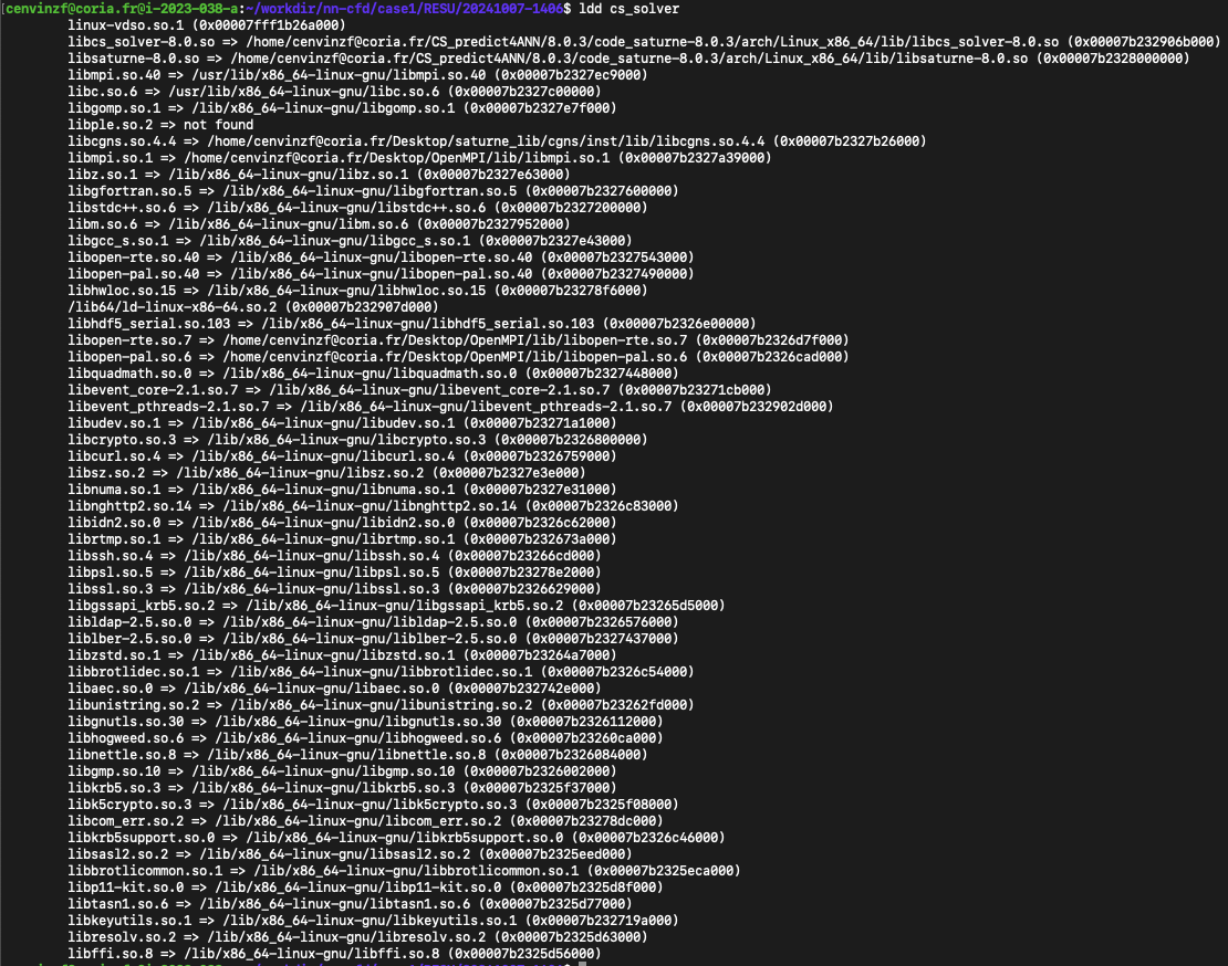

Here it is the output of ldd for a running case:

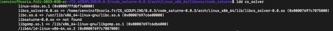

This one is when i do it in the installation directory:

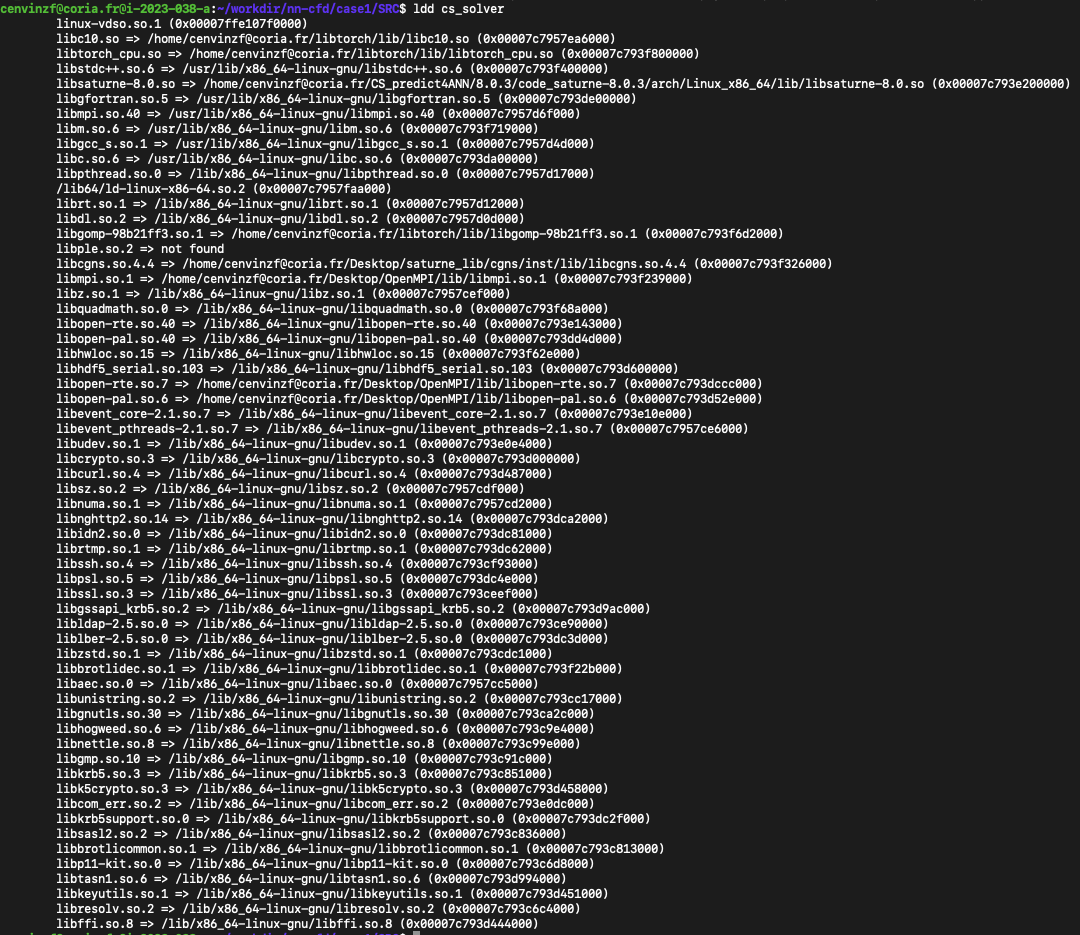

Whereas this one is for the additional library case:
Do you see anything that can help?
Francesco
Posts: 4302
Re: Library not found with custom compile file
I see that libple.so is already "not found" in the basic setup (but probably works through the additional LD_LIBRARY_PATH) set by the code in run_solver).

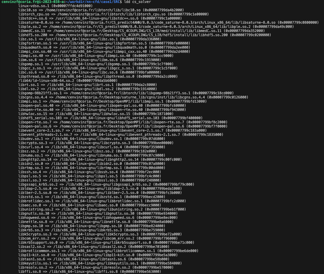

I did as you suggested and now it seems that the code sees libple.so (as shown in the output of ldd cs_solver, obtained via external compile of the source files).
Yet, when i do launch the run command, no output is produced again (same when i compile externally). I'm wondering that there might be some issues in the subroutines i'm also trying to implement, like cs_user_extra_operations.c, where i try to recompute the time of the simulation.

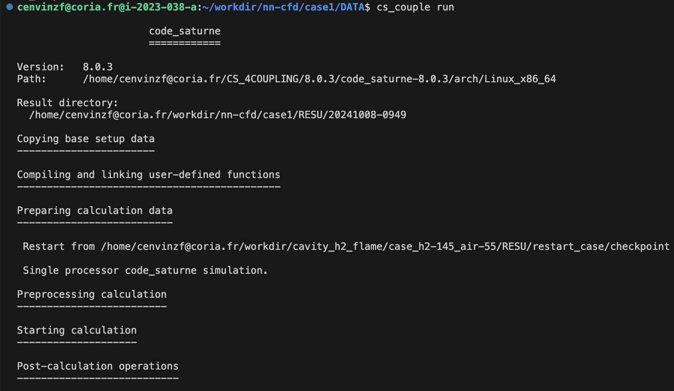

This is the output of the terminal when i run the code:
I cannot see any run_solver or cs_solver yet in the RESU folder.

I do not understand why there is no visible error message at any stage. Is your machine a standard Ubuntu machine, or a VM running on a Mac ? (guessing from the junk OS X adds to folders) ? It should not make a difference in theory, but there might be subtle effects...
Instead of simply running "code_saturne run" (or "cs_couple run"), could you add "--initialize" to the command (i.e. "cs_couple run --initialize") ?
This should prepare the code for a run, but leave the run_solver script in place, as well as the cs_solver executable.
I am interested both in the content of 'run_solver' and output of ("ldd cs_solver"), as well as any error message you get when running ./cs_solver.
If the code does not get that for, it may mean the error is actually not where we are searching for it, but we might have somehting that causes a premature return in a Python function.
