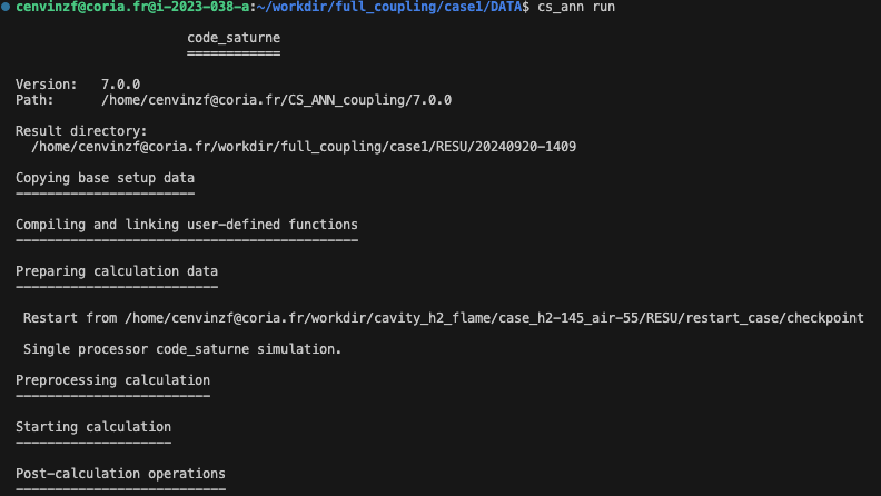

Thank you very much Yvan, it worked perfectly. However, now i have another issue: it seems to perfectly compile everything as in the compile.log file there are no errors (only warnings on unused variables), yet the calculation doesn't even start with the first iteration and it gives me no error message whatsoever. I attached the files that are produced by the code at the end of the computation.
Do you have any idea of what can possibly cause this behavior?

Do you get any info in the terminal in which the computation is launched (if interactive) or in the batch log files ?
Is the cs_solver file created ?

In my terminal i have no relevant information.
In the only log that i have (compile.log), everything seems to be linked in the right way. In the following is the last line of the terminal:
When i try to compile first (using code_saturne compile) the cs_solver executable is produced but gives me the error:
Any suggestion?
/usr/bin/cc -o /home/cenvinzf@coria.fr/workdir/full_coupling/case1/RESU/20240920-1202/cs_solver cs_user_extra_operations.o cs_meg_initialization.o cs_meg_boundary_function.o cs_user_initialization.o cs_user_parameters-base.o predict.o cs_f_user_physical_properties.o cs_user_parameter.o -lcs_solver -L/home/cenvinzf@coria.fr/libtorch/lib -lc10 -ltorch -ltorch_cpu -lstdc++ -L/home/cenvinzf@coria.fr/CS_ANN_coupling/7.0.0/lib -L/home/cenvinzf@coria.fr/Desktop/saturne_lib/cgns/inst/lib -L/home/cenvinzf@coria.fr/Desktop/med/lib -L/home/cenvinzf@coria.fr/Desktop/hdf5-200/inst/lib -L/home/cenvinzf@coria.fr/Desktop/OpenMPI/lib -O -Wl,-export-dynamic -fopenmp -lsaturne -lple -lcgns -lmedC -lhdf5 -lmpi -lz -ldl -L/home/cenvinzf@coria.fr/opencv_folder/lib -L/home/cenvinzf@coria.fr/cppflow/lib -L/usr/lib/gcc/x86_64-linux-gnu/11 -L/usr/lib/x86_64-linux-gnu -L/usr/lib -L/lib/x86_64-linux-gnu -L/lib -L. -L/home/cenvinzf@coria.fr/opencv_folder/include -L/home/cenvinzf@coria.fr/cppflow/include -lgfortran -lquadmath -lm -Wl,-rpath -Wl,:/home/cenvinzf@coria.fr/libtorch/lib:/home/cenvinzf@coria.fr/CS_ANN_coupling/7.0.0/lib:/home/cenvinzf@coria.fr/Desktop/saturne_lib/cgns/inst/lib:/home/cenvinzf@coria.fr/Desktop/med/lib:/home/cenvinzf@coria.fr/Desktop/hdf5-200/inst/lib:/home/cenvinzf@coria.fr/Desktop/OpenMPI/lib:/home/cenvinzf@coria.fr/Desktop/OpenMPI/lib/../lib:/home/cenvinzf@coria.fr/opencv_folder/lib/../lib:/home/cenvinzf@coria.fr/opencv_folder/include/../lib:/home/cenvinzf@coria.fr/cppflow/lib/../lib:/home/cenvinzf@coria.fr/cppflow/include/../lib:/home/cenvinzf@coria.fr/Desktop/OpenMPI/lib:.:/home/cenvinzf@coria.fr/opencv_folder/lib:/home/cenvinzf@coria.fr/opencv_folder/include:/home/cenvinzf@coria.fr/cppflow/lib:/home/cenvinzf@coria.fr/cppflow/include
