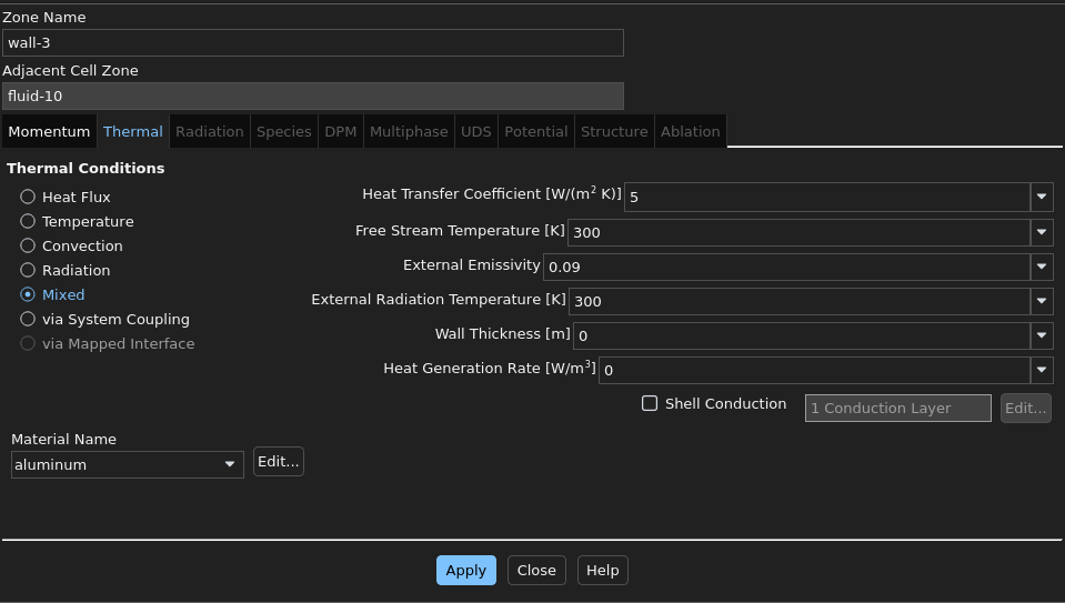

I'm trying to simulate a hot gas flow through ducts in Code_Saturne. I was wondering how to setup a boundary condition on the wall that combines:
* a heat transfer coefficient + outer temperature (representing the convection between the external wall and the ambient)
* an emissivity at the outer wall + outer temperature (representing the radiation from the externall wall to the ambient)
(* perhaps it would be nice also to include the conduction in the wall, but this may be calculated analytically and included in the heat transfer coefficient mentioned above)
All this WITHOUT simulating the solid. Just simulating the fluid flow.

For the reference, for those who are familiar with it, in ANSYS Fluent, the configuration of such a BC looks like in the attached picture (without conductivity. Just a heat transfer coefficient + an emissivity for the radiation to the ambient).
