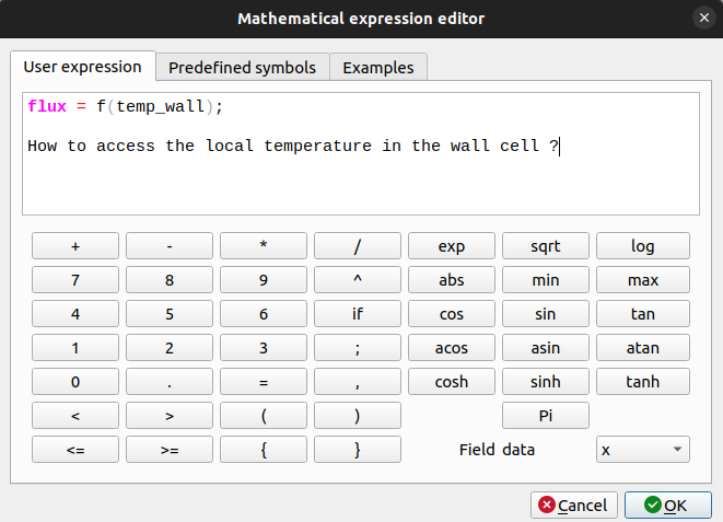

I agree with you that this should be possible without including a thermal radiative heat transfer model for the gas flow.To see the effect of radiation on.the wall, I think only the thermal BC type involving a balance computation at the wall will/should work for this.
However, I am not familiar with coding in code_saturne, and I don't know how to access the local temperature in the cell located on the wall boundary patch (inner wall).
If I knew how to access that temperature (or the temperature on the boundary patch, say T_wallint), I would use a user-defined boundary condition for the outgoing flux and write something like this:
T_amb = 25; // °C - ambient temperature
lambda_wall = 20; // W/m/K - thermal conductivity of the duct wall
e_wall = 0.001; // m - wall thickness
h_conv = 5; // W/m2/K - natural convection heat transfer coefficient at the external surface of the duct
eps_wall = 0.85; // - emissivity of the external surface of the duct
sigma = 5.67e-08; // - Stefan constant
// One needs to calculate iteratively (or with root-finding) the temperature on the external wall surface T_wallext
// that satisfies: (1) the value of T_wallext must be between T_wallint and T_amb, and (2) q_cond = q_conv + q_rad
// with q_cond = (lambda/e_wall)*(T_wallint - T_wallext)
// q_conv = h_conv*(T_wallext - T_amb)
// q_rad = sigma*eps_wall*((T_wallext+273.15)^4 - (T_amb+273.15)^4)
// if the wall is very conductive, one can assume T_wallext ~= T_wallint and then calculate the flux directly from
// q_conv+q_rad
flux = q_conv; // the outgoing flux in the boundary cell

I do not think you can access this value from the GUI, so you need to handle this with a user-defined function. It would indeed be an interesting addition.
Actually, since the GUI-defined user expressions are used by the code to generate and compile code similar to that of user-defined functions (cs_meg_* instead of cs_user_*), it is possible to insert actual code in the middle of an expression, but this is not guaranteed to work with future versions (as the syntax can change a bit), and requires some additional trial and error, so a true user-defined function is recommended instead.
