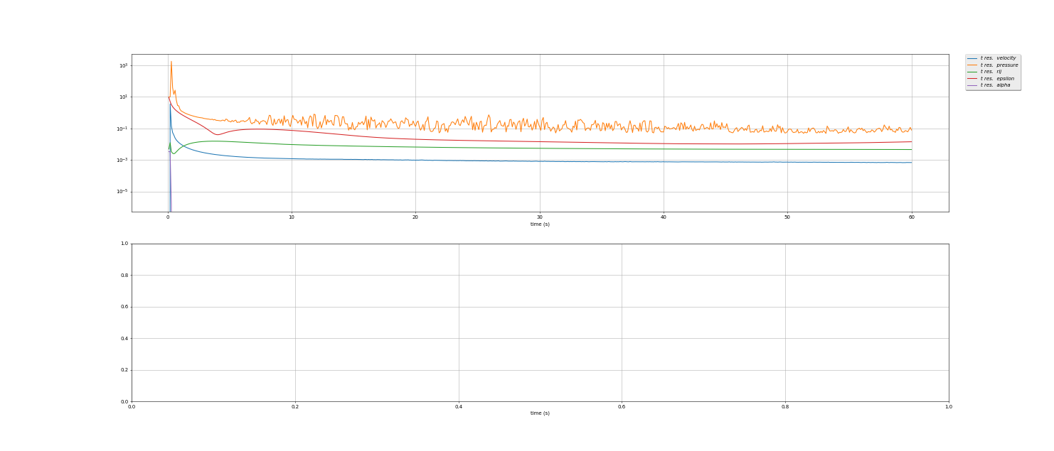

Thanks for the prevoiusly informations. I have studied the link and many questions come.
They are mainly led to the influence between choices about numerical parameters and accuracy of the reults
I have resumed the in the attachment
Could you have a look?
Best regards
Best regards

Re: setting boundary inlet turbulence conditions
i join the xml file
