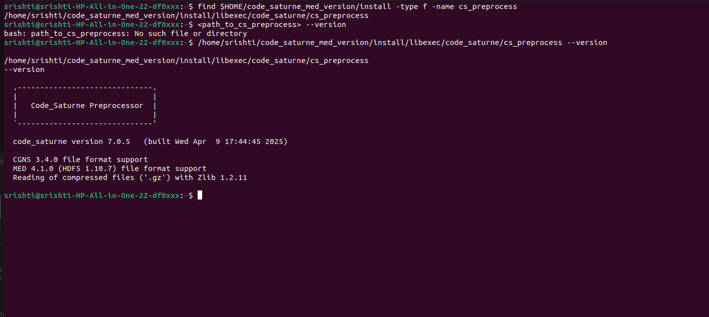

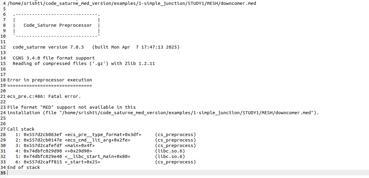

I am facing the same issue.
I have installed code_saturne-7.0.5. , I thought it was specific to my case, but today I ran one of the examples and I still get the following error.
"File format "MED" support not available in this" (even after assuring that it has MED compatibility in version specifications)
I have attached the image of the error and the details of my code_saturne specifics.
Please let me know your suggestions when time permits.
Thankyou!
- Best Srishti
Thankyou!
- Best Srishti

In the 2nd image, I do not see the 1st 3 lines, containing the install paths, but I see the build dates are not exactly the same (3 minutes difference) in the 2 cases, so I suspect that either :
- You have 2 different installs, one with MED support, the other without.
- You overwrote the fixed install with MED support with an older setting without MED support.
I'll let you check which might be the case..

Hi Yvan,
Thanks a lot for looking into the details — you were absolutely right! I've now corrected the environment to point to the right installation, and everything is working fine.
Really appreciate your help!
Srishti
