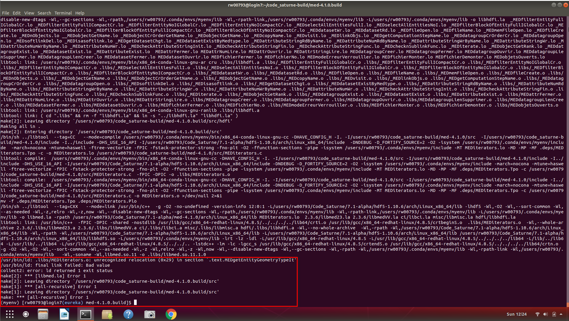

Thank you so much. Following your kind suggestion, I ran "make clean" and then "make" in the med-4.1.0.build folder. Unfortunately, the same error appeared. Please find the config.log and Makefile attached.
Thanks Yvan, I also found some conda issues in this forum. This is the first time I use Anaconda. Since I need to install some python related softwares, for example pyqt5, the IT supporter from the university cluster suggested, it's better to use Anaconda. Please could I ask if you have some suggestions or experience, is there a better choice than using conda?
(On my local Ubuntu PC, I use Synaptic Package Manager to install the pre-requisites, then the installation will run smoothly. But I'm not familiar with the Centos7 remote cluster.)
