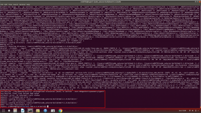

Dear developers,
Please could you help me with this problem:
I have been using Code_Saturne on my local PC for about one year, the progress is good, thanks to the great support from Yvan. Now I am trying to use a remote cluster, for some big cases. But I met a problem when installing on the cluster (based on Centos7).
The installation was in my self-built environment, and I used Anaconda to install the pre-requisites.
I was trying to install the latest source codes from GitHub, use the semi-automatic installation method, which always succeeds on my local Ubuntu PC. But on the remote cluster, one error occurred when compiling MED, while the previous HDF5 and CGNS seem ok:

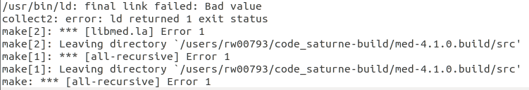

The install_saturne.log file showed:
/usr/bin/ld: final link failed: Bad value
collect2: error: ld returned 1 exit status
Could you please guide me on how to figure out this problem?
Many thanks,
Ruonan
Many thanks,
Ruonan

The "/usr/bin/ld: .libs/MEDiterators.o: unrecognized relocation (0x29) in section `.text.MEDgetEntityGeometryTypeIt'"
error you encounter is not some erro I have seen before...
Could you try:
and post the output ? (if there is no error on this second try, simply also run "make install", and change the code_saturne installer setup to use this install for MED instead of reinstalling it (i.e. install=no path=<path>)
If it fails the same way, could you also post the config.log and Makefile in that same directory ?
Note that in general I have a bad feedback with Conda (I have never used it myself, but you are not the first user installing code_saturne with conda who encounters strange issues, usually due to a strange soup of environment variables).

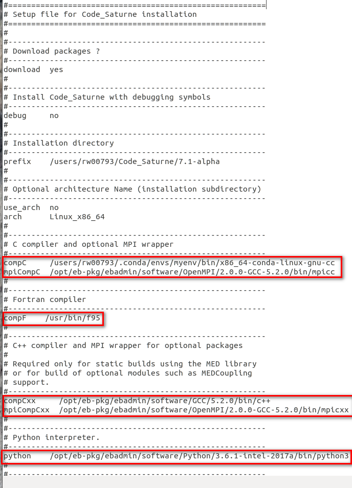

I tried one more time, avoided using the compilers in conda environment. I loaded the compilers from outside conda environment, except for C compiler (the /usr/bin/cc do exist, but it doesn't work). As shown in the figure below.
Luckily, now I don't have the MED error mentioned in the last post. But I met another error, in the compile stage of scotch. Checking the install_saturne.log file, the errors are:
Many thanks,
Ruonan

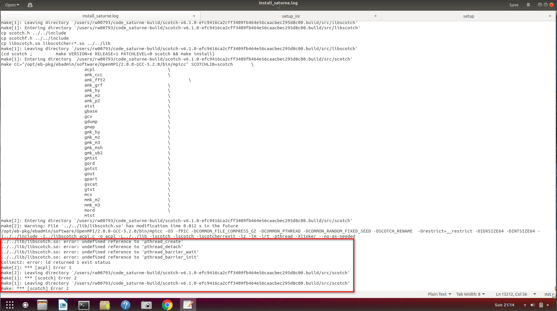

This is an error in the build of PT-Scotch. You might be able to fix this in the scotch sources directory, by editing src/Makefile.inc, replacing -pthread by -lpthread in LDFLAGS.
I do no know why the base setup works outside of Conda and not inside though. I would guess it is related to different compilers/linkers being used, but would not expect this sort of impact using compilers of a same series (i.e. different versions of gcc).

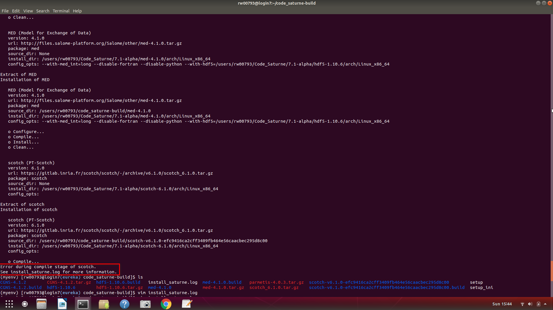

Re: Error when compiling MED while installing on a remote cluster
Thank you very much. Thanks for your suggestions, I agree with you, the issue might be due to the incompatible compilers/linkers being used. So I tried another time, started at the very beginning, "module purge" and then "module load" the compilers.
The currently loaded modules are:
The setup_ini showed the compilers' versions are changed, though I'm not 100% sure this time will have no compatible problems.
When I installed this time, the last error in the "compile stage of scotch" disappeared. But an error occurred in the following step, "Error during configure stage of parmetis". From the log file, I found it's some cmake error.
Could you please kindly guide me on how to get around this error? I think I might be almost there.
Many thanks,
Ruonan

Thank you very much. I made some progress but still have one more question please.
I tried to install without conda environment, and loaded the compilers wrappers carefully with the identical version. This time the HDF5, CGNS, Scotch and ParMetis can be installed smoothly.
But an error occurred during the compile stage of Code_Saturne, as shown below. I learned this may due to library linking. Could you please guide me on how to get around this error? I have already loaded the "zlib" and "libtool" modules, but the error was still there.
/opt/eb-pkg/ebadmin/software/binutils/2.26-GCCcore-5.4.0/bin/ld.gold: error: cannot find -libverbs
make[3]: *** [libsaturne.la] Error 1
make[3]: Leaving directory `/users/rw00793/code_saturne-master.build/src/apps'
make[2]: *** [all-recursive] Error 1
make[2]: Leaving directory `/users/rw00793/code_saturne-master.build/src'
make[1]: *** [all-recursive] Error 1
make[1]: Leaving directory `/users/rw00793/code_saturne-master.build'
make: *** [all] Error 2
Currently Loaded Modules:
1) cmake/3.16.5 3) binutils/2.26-GCCcore-5.4.0 5) numactl/2.0.11-GCC-5.4.0-2.26 7) OpenMPI/1.10.3-GCC-5.4.0-2.26 9) M4/1.4.17
2) GCCcore/5.4.0 4) GCC/5.4.0-2.26 6) hwloc/1.11.3-GCC-5.4.0-2.26 8) zlib/1.2.8-GCCcore-5.4.0 10) libtool/2.4.6
