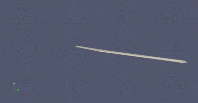

1) The "cs_turbomachinery_set_rotation_velocity" function worked perfect when we called it from the subroutine cs_user_extra_operations-turbomachinery.cpp. Next we have attached a simple gif with the movement of an object that one can obtain using the turbomachinery model.

Everything is working perfect now. We have attached a gif where it can be seen the object moving with a prescribed rotation and displacement.
