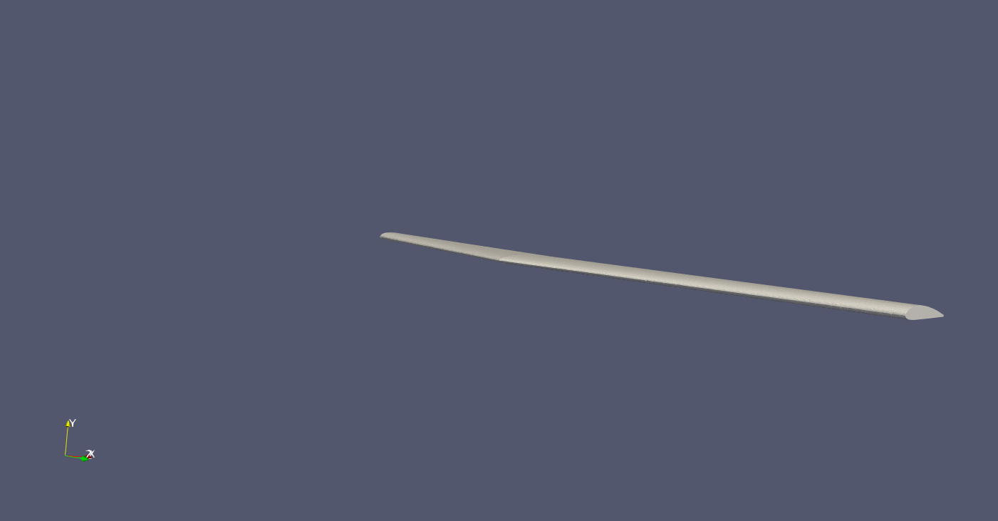

1) The "cs_turbomachinery_set_rotation_velocity" function worked perfect when we called it from the subroutine cs_user_extra_operations-turbomachinery.cpp. Next we have attached a simple gif with the movement of an object that one can obtain using the turbomachinery model.

Object movement in turbomachinery model
