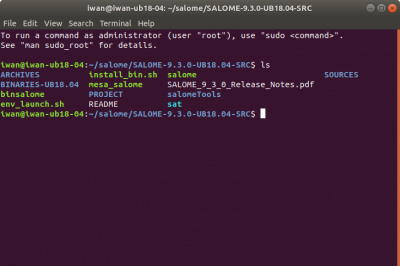

For Yvan, I got the different directory structures consisting only one folder (screenshot attached). As you can see in my config file before, I need to specify all bin, include, and lib dirs instead of --with-med=salome \.
I attached also the config.log. So far, I have tried 4 versions of salome: ub18.04_src, univ, univ_withOT, and meca_2019.0.0. Only the 18.04 that:
1. tells me which library am I lacking (others has the same problem with Jeremy, requires python2 and at the end CS cannot be compiled due to module not found)
2. has different directory structure. other version has your descrption, e.g. for meca 2019 : appli_V2019_univ and V2019_univ.
Could you help me configure salomeenv (probably in cs_salome.py file at prefix/lib/.../code_saturne)? if the directory structure is the standard one, I can try the one suggested here https://www.salome-platform.org/forum/forum_9/623843773.
