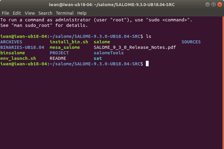

Re: Issue when installing CS 6.0.0 with Salome - Ubuntu 18.04
Hello all,
Thank you for the fast replies.
For Jeremy, you need to compile Salome first if you want to integrate CFDSTUDY since you need salome libraries directores [KERNEL, MED,CGNS, etc.]. I do not know if using python2 be the cause or not, so can you try compiling only with python3? You can use my config file posted before. The upper part consist of libraries I need to install from synaptic package manager so salome can run and code_saturne can be configured to "make" stage. These are fresh from minimal install of 18.04.
For Yvan, I got the different directory structures consisting only one folder (screenshot attached). As you can see in my config file before, I need to specify all bin, include, and lib dirs instead of --with-med=salome \.
I attached also the config.log. So far, I have tried 4 versions of salome: ub18.04_src, univ, univ_withOT, and meca_2019.0.0. Only the 18.04 that:
1. tells me which library am I lacking (others has the same problem with Jeremy, requires python2 and at the end CS cannot be compiled due to module not found)
2. has different directory structure. other version has your descrption, e.g. for meca 2019 : appli_V2019_univ and V2019_univ.
Could you help me configure salomeenv (probably in cs_salome.py file at prefix/lib/.../code_saturne)? if the directory structure is the standard one, I can try the one suggested here https://www.salome-platform.org/forum/forum_9/623843773.
Kind regards,
Iwan

- Posts: 4290
I have an Ubuntu 18.04 VM available on my home (Arch Linux) machine, so I'll probably download the Ubuntu 18.04 version to run some tests, but maybe not before a day or 2.
Did you test the installation and execution under a salome shell ? In this case, it may also be useful to add "--with-modules=no" to the code_saturne configure command so that code_saturne lets SALOME manage environment modules (if present) and does not interfere trying to purge and reload them.
This might work right away.
In any case, Salome 9.x has been ported to Python 3, and some modules may not be compatible with Python 2 anymore, so I recommend everyone to forget about solutions involving Python2, which is nearing retirement anyways.
