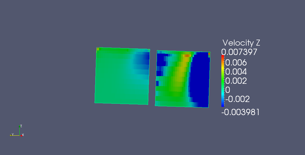

I used a shift vector of 1.15 along the x direction to map the inlet just before the outlet as you were suggesting (the domain dimension along this direction is 1.2).
The case has converged but as it can be seen with the pictures attached, the y and z components of the velocity are totally different between the inlet and the outlet (see picture Uz-saturne.png for instance). I know that it is possible to keep these components with a mapped-inlet with OpenFOAM for instance (see the other picture Uz.png attached, but ignore range of the value taken since the inlet velocity is not the same)

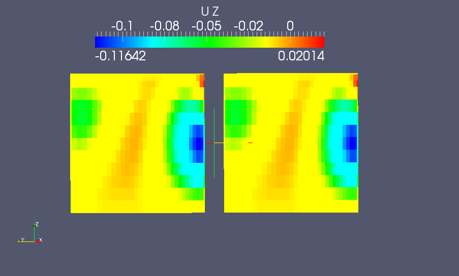

And here is the picture taken with a mapped inlet using OpenFOAM (I don't know why it wasn't sent with my previous message)

I think that I was not clear enough, sorry about that. In fact, I need to study these recirculation effects.
So, ideally, I would like to have a "true" mapped inlet : since there are some recirculations at the outlet, I would like them to be also mapped and "find" them at the inlet.
Said differently, I would like to fix the inlet velocity equal to the outlet velocity after the first iteration, which means using the outlet as a new inlet, without any normalization, at each time step. For instance, the y and z recirculations which appear at the outlet should be seen and re-injected at the inlet, as it is the case on the OpenFOAM picture I posted in my previous message, where the recirculations are also mapped.
