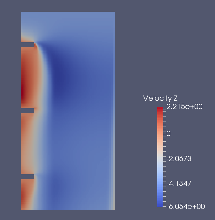

I guess I know what cause the problem. The contour shows the streamwise velocity of the channel (downward flow, inlet from the top and outlet from the bottom), because of the ribs on the left wall, there are re-circulations near the rib wall. If the subroutine copy the outlet velocity field and impose it to the inlet, it will cause problem, because the inlet boundary condition only allow "inject" but not "extract". Do you have a solution on this? How to copy the outlet velocity field to the inlet in such flow, to make it periodic? Thanks for the time.
Posts: 4276
Re: Question about the mapped inlet subroutine
For this case, using a true periodicity condition and a momentum source term to ensure the bulk flow velocity is probably the cleanest solution (this is what we do for our own "ribs" case, with the attached file).
