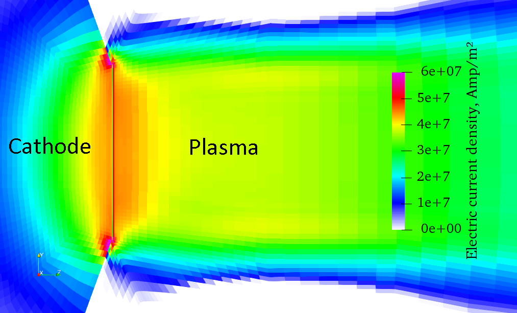

Hello everyone,
Since Code_Saturne 5.1 is still not available for Windows I decided to develop my own coupling algorithm for enthalpy, electric potential and magnetic vector potential to sew solid part of the domain with fluid. (please find the description attached)
I separated the electrodes from the rest of the domain using automatically defined thin walls by cs_user_internal_coupling_add_volumes. Then using my algorithm I sewed electric potential with respect to electric conductivity, because in metal the conductivity is much higher. But I found significant discontinuity in electric current at the interface of metal and fluid (please take a look at the picture attached). Hence, I decided that my sewing algorithm is not good enough, so I tried to sew electric potential by
At the same time I kept my algorithm for enthalpy and magnetic vector potential coupling.
But it just did not work, the electric potential field in the electrodes was not adequate to the electric field in the fluid.
Does someone know what is the problem here? What am I doing wrong?
Rodion
void
cs_user_internal_coupling(void) {
int f_id = cs_field_id_by_name("elec_pot_r");
cs_internal_coupling_add_entity(f_id); /* Field to be coupled */
Rodion

- Posts: 4234
Re: Zero gradient at certain faces
Don't expect a Windows build of 5.1 soon: viewtopic.php?f=4&t=2034
For the values you obtain, I do not have enough details to guess of check. In any case, internal coupling results should be dependent on wall exchanges. I seem to remember your case is laminar, which at least avoids additional complexity.
Also, I am not 100% sure that the internal coupling as of version 5.0 or even 5.1 works well with multiple scalars (at some point it was not usable at all, and there have been succeeding improvements, but might still be limitations; the simplest way to check this would be with a simple (no-specific physics) test case with 2 scalars, coupling only the first, then both, then only the second, and comparing). There should be a few improvements to internal coupling in upcoming 5.2, but I still need to check that part.
