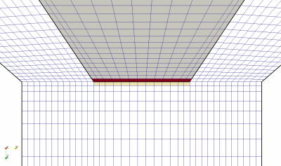

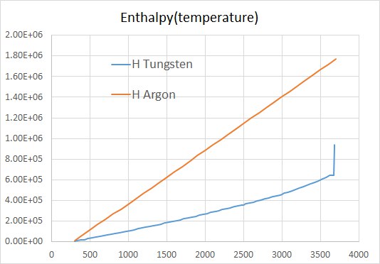

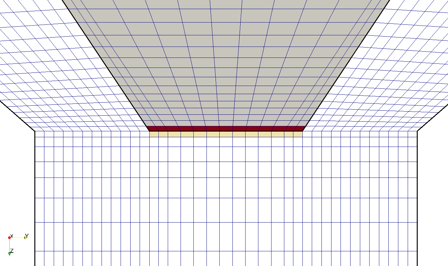

Thank you for your answer, Yvan.
Please find the scheme of the mesh near the cathode below. Grey cells are Tungsten, white cells are Argon. I need to isolate thermally one from another and calculate my custom thermal flux through the interface.
These two media have different Enthalpy(temperature) dependencies, that's why thermal flux between Tungsten and Argon has to be calculated through temperature. But Code_Saturne calculates thermal flux through Enthalpy, hense I have continuity of Enthalpy, which is not correct. There should be continuity of Temperature.
Rodion
Rodion

I assume the tungsten cathode is a solid, and Argon the fluid domain.
How do you model the solid ? Do you use Syrthes coupling ? In Code_Saturne version 5.0, you could try to use the internal coupling option, though it has not been tested using Enthalpy is is not very mature (still in development). Still, it would seem the best option, if you are ready to test development features.
For this, the Windows build is not ideal, though running on Windows, you could use Cygwin or the Ubuntu for Windows subsets to install a development version (or 5.0 with possible patches) if following detailed (but not so complex) installation instructions/recommendations is OK for you.
Re: Zero gradient at certain faces
I recalculate and impose Tungsten and Copper properties like T(H), Cp(T), Sigma(T), Lambda(T), density in cs_user_physical_properties.f90. I don't use Syrthes.
Sorry, I don't really understand, how the subroutine cs_user_fluid_structure_interaction.f90 is related to thermal isolation of neighboring cells.
Could you please explain, is it possible to impose zero gradient for enthalpy between neighboring cells to thermally isolate them and then calculate thermal flux between these cells manually?
Or maybe I can impose thermal isolation of the cells group in some different way?
Thanks in advance.
Rodion
Thanks in advance.
Rodion
cs_user_fluid_structure_interaction.f90 is for "displacment" type coupling, so not what you need. I was mentioning another internal coupling in Code_Saturne 5.0.
It is still not clear to me how you model the electrodes. The Tungsten one seems to be part of the mesh, but if it is not fluid, how do you manage it ? That is where a coupling with Syrthes (not available on Windows unless you recompile both codes) or an internal coupling may help, as it allows for regions with just diffusion and no convection.
Otherwise, there is no easy way of imposing a gradient inside the domain (such as is possible using boundary conditions). This would require modifying the code so as to add a user section after each gradient call (not too difficult, but untested, and I'm not sure about possible effects on model/equation consistency).
The internal coupling from v5.0 allows for thermal wall laws, so even if its postprocessing aspects are not mature yet, it would seem the best option here.
Otherwise, you would need to insert a boundary between the fluid and electrodes, and then manage a coupling on that boundary to handle heat exchange. Some low-level functions I coud point you to may help.

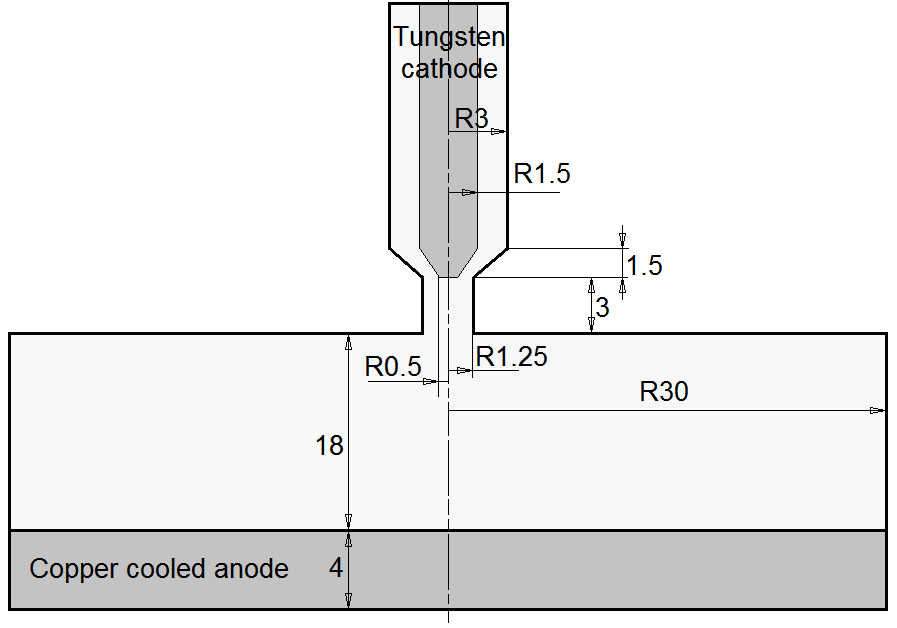

Thank you for your answer Yvan.
For electrodes I impose momentum source like this:
crvimp(1, 1, iel) = -1.0d30
crvimp(2, 2, iel) = -1.0d30
crvimp(3, 3, iel) = -1.0d30
crvexp(1, iel) = 0.0
crvexp(2, iel) = 0.0
crvexp(3, iel) = 0.0
which results in very low velocity (1e-10 ÷ 1e-5 m/s) in the cells dedicated to the electrodes.
Also I impose density, temperature(enthalpy), Cp(temperature), Sigma(temperature), Lambda(temperature) corresponding to the calculated electrode enthalpy.
Do you think it is inappropriate approach?
Another technique was mentioned in the thesis written by Laurent Chemartin: imposed custom specific heat at the interface faces between metal and fluid.
What do you think about it?
