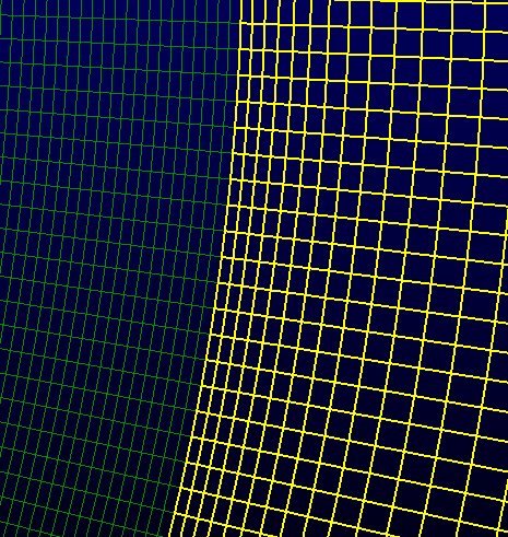

yany
Posts: 60
Joined: Fri Aug 04, 2017 11:02 pm
Re: error : Cannot achieve to reorient the current joined fa
Post by yany »
Yvan Fournier wrote:Hello,
It seems you did not post the mesh. A few views of the mesh near the joining interface might be enough if the mesh is big.
How is the rotor/stator interface meshed ? Did you use a general triangle surface mesh, or a mesh of quadrangles generated by rotational extrusion ? The second option would be better.
I any case, similar questions have been asked and answered on this forum in the last 2 or 3 years, so I recommend using the search feature of the forum for this.
You do not need to have a positive gap between parts, but ensuring you have one could lead to being able to use more aggressive joining options... which might not be such as good idea quality-wise a as cell volumes could then vary slightly from one time step to the next...
I'm so grateful for your kind help. I searched the related key words in the forum and did what I can do for that, but the error still exist. The interface mesh is attached. Is there any problem about that?
Thank you so much.
All the best, Yany.
Posts: 4299
Did you check the attachments ? All I see are "logo" type images.
yany
Posts: 60
Post by yany »
I'm sorry that there may something wrong with the attachment. Now I upload a second time, entire mesh and the interface of rotor and stator.
There is an new error after I modified the mesh.
Error in turbomachinery mesh update:
Number of boundary faces has changed from 59700 to 59718.
There are probably unjoined faces, due to an insufficiently regular mesh;
adjusting mesh joining parameters might help.
Thank you so much.
All the best, Yany.
Posts: 4299
Your mesh seems quite clean. The geometry might be slightly off in the normal direction, sto one face is not completely joined but leaves a small "splinter" as a boundary faces.
You may try slightly increasing the joining fraction parameter for the turbomachinery module (for example from the default of 0.1 to 0.15).
