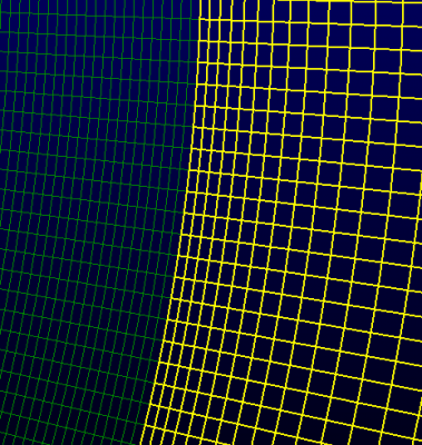

I'm so grateful for your kind help. I searched the related key words in the forum and did what I can do for that, but the error still exist. The interface mesh is attached. Is there any problem about that?
Thank you so much.
All the best, Yany.

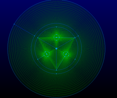

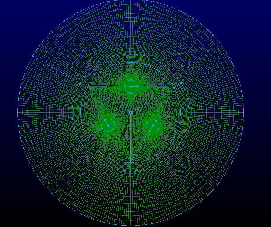

I'm sorry that there may something wrong with the attachment. Now I upload a second time, entire mesh and the interface of rotor and stator.
There is an new error after I modified the mesh.
Error in turbomachinery mesh update:
Number of boundary faces has changed from 59700 to 59718.
There are probably unjoined faces, due to an insufficiently regular mesh;
adjusting mesh joining parameters might help.
Thank you so much.
All the best, Yany.
- Posts: 4272
Re: error : Cannot achieve to reorient the current joined fa
Your mesh seems quite clean. The geometry might be slightly off in the normal direction, sto one face is not completely joined but leaves a small "splinter" as a boundary faces.
You may try slightly increasing the joining fraction parameter for the turbomachinery module (for example from the default of 0.1 to 0.15).
