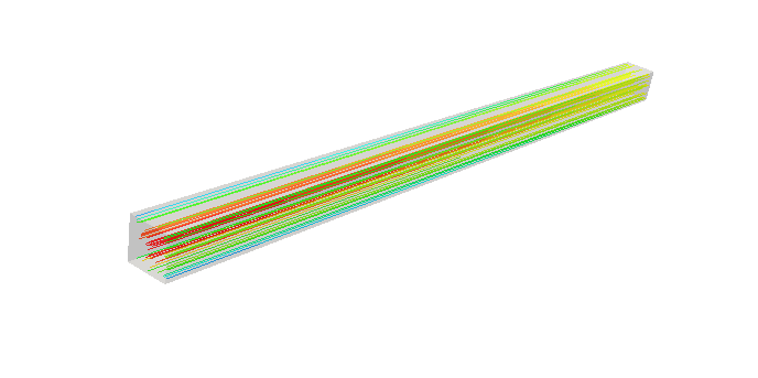

I am trying to model internal wall as baffle using Code Saturne 4.2. During mesh creation I have created an internal face with name baffle. Also I have used subroutine cs_user_mesh.c as attached below. But baffle is not being detected in preprocessor listing so I am unable to provide wall boundary condition to baffle. Code saturne compiles user subroutine without error and run goes well but it do not take internal wall into account. Since flow is not affected by baffle streamlines are straight as shown below.

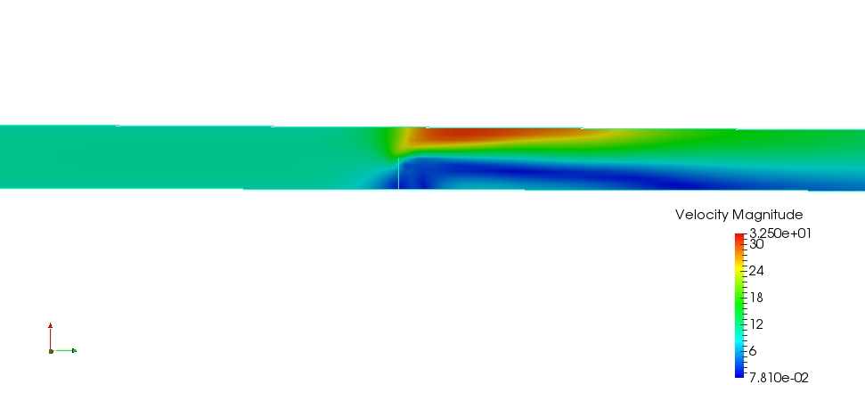

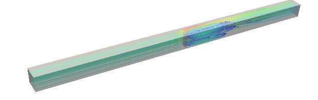

Instead I am expecting flow to go like shown in picture below after detecting baffle

I am attaching images once again below. I am expecting flow to turn around baffle as shown in expected result.

Expected result
Expected result
Actual Result
Actual Result

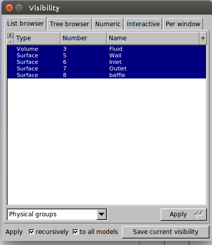

I have checked physical groups in gmesh and boundaries given in code saturne and they do match. I have attached snapshots for reference.

Physical groups
Physical groups

Posts: 4299
Re: Internal wall not detected in code saturne 4.2
Your selection criteria in the user subroutine is wrong, as Code_Saturne does not currently handle GMSH physical group names, but simply numbers.

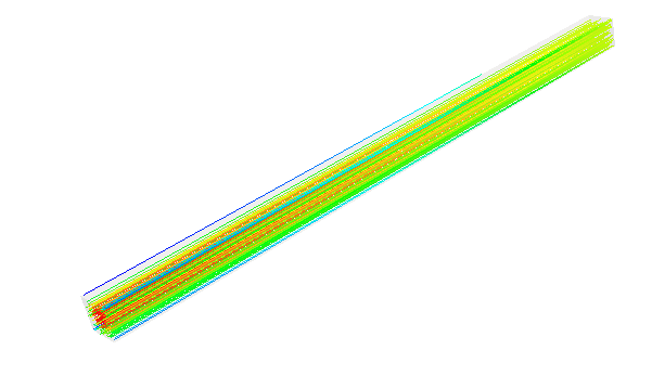

Inspite of using group number "8" instead of its name result do not change. snapshot of straight streamlines is attached below.
Thanks and regards,
Sagar
Streamline
Streamline

I uploaded an user function and a case file where your problem it is working (I attach a figure).
I used the default values in the user fuction like in the /REFERENCE/cs_user_mesh.c using as selection criteria "8" and the same selection criteria in the GUI to impose the wall BC.
Please, check if it is works for you.
Luciano
