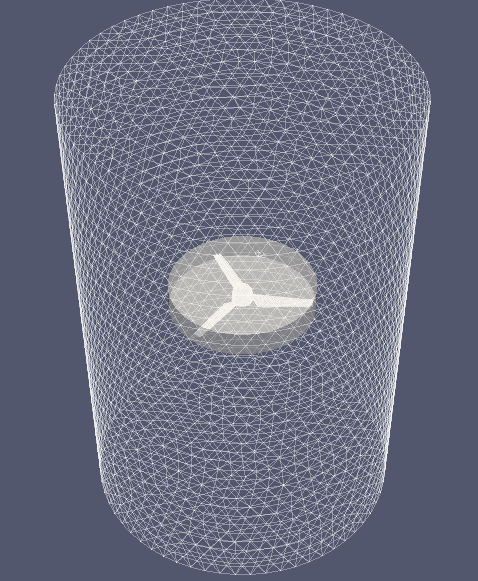

Now i want to use this model to simulate a water turbine.This machine is just like a wind turbine.I don't know how to define the boundary conditions of the interface .As is shown in the picture.the face 1 2 3 is the interfaces belong to rotor and stator,so each of them have two same face(1 and 1s,2 and 2s ,3 and 3s).so my question is how to define them.
Please excuse me for my broken English and wish you can help me.
thanks a lot .

If I understand your description correctly, simply use "1 or 2 or 3" as the selection criteria for the face joining in the "Turbomachinery" section (assuming your face groups really are named 1, 2, and 3; adjust for names if needed).

In my mesh which had been set,the face name '1' covered two different faces.Because it's not only appear on the rotor but also on the stator. so I defined this two faces with different names '1' and '1s'.The face named '1' is belong to the stator,and the face named '1s' belong to the rotor.It's the same with face '2' and '3'.So there are six faces in total that i don't know how to define.
Eagerly awaiting your reply.
Best regards
Li

"1 or "1 s' or 2 or '2s' or 3 or '3 s'"

As you said in your reply ,I named those faces with different numbers and I use "1 or 2 or 3 or 4 or 5 or 6"as the selection criteria for the face joining in the "Turbomachinery" section.
Now,it seems to work well.
And the question is that I have selected to post the normal and tangential stress in the GUI,and I can visualize them in Paraview. But I don't know how to get the detailed numerical forces which acted on the blade .
