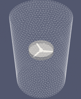

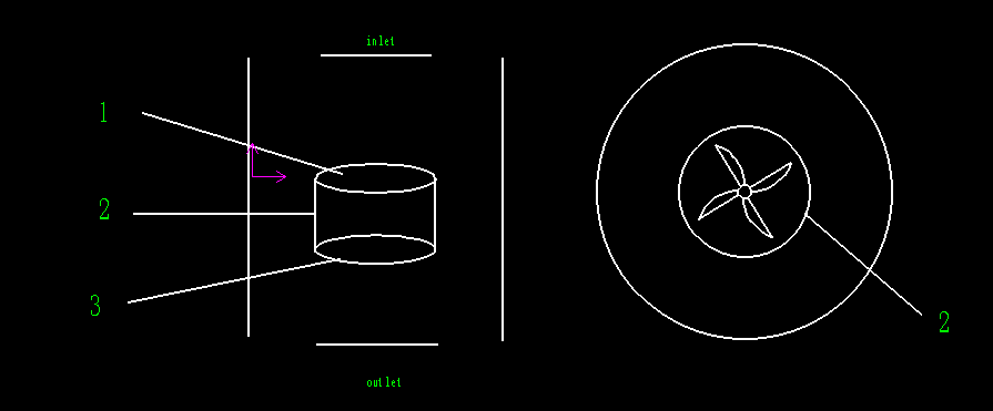

I am a fresh hand of using this software,but the model of turbomachinery attracted me a lot.
Now i want to use this model to simulate a water turbine.This machine is just like a wind turbine.I don't know how to define the boundary conditions of the interface .As is shown in the picture.the face 1 2 3 is the interfaces belong to rotor and stator,so each of them have two same face(1 and 1s,2 and 2s ,3 and 3s).so my question is how to define them.
Please excuse me for my broken English and wish you can help me.
thanks a lot .
jddcx
Posts: 4290
Re: Turbomachinery module
If I understand your description correctly, simply use "1 or 2 or 3" as the selection criteria for the face joining in the "Turbomachinery" section (assuming your face groups really are named 1, 2, and 3; adjust for names if needed).
jddcx
Posts: 8
Joined: Thu Sep 29, 2016 2:14 am
Post by jddcx »
Yvan Fournier wrote:Hello,
Hi Yvan,
Thank you for your reply.
In my mesh which had been set,the face name '1' covered two different faces.Because it's not only appear on the rotor but also on the stator. so I defined this two faces with different names '1' and '1s'.The face named '1' is belong to the stator,and the face named '1s' belong to the rotor.It's the same with face '2' and '3'.So there are six faces in total that i don't know how to define.
Eagerly awaiting your reply.
Best regards
Li
Posts: 4290
Having spaces in names makes things more complicated (you need to "escape" the whitespace, either with different quotes or a backslash).
Try:
"1 or "1 s' or 2 or '2s' or 3 or '3 s'"
