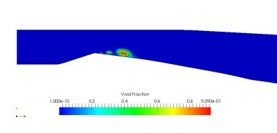

As Benoît mention the problem was in the pressure. In your case if you set a and the outlet pressure according to the cavitation number you will get the cavitation of the fluid at the throat. I have run you case with a dt=5e-6 [s] and the results are reasonable according to the paper "Development of algorithm based on the fractional time step for the simulation of cavitation".
Also I notice that the dimensions of your venturi are smaller that the used in this paper, so you have to be careful if you want to compare the results, because you Reynolds number will be different. It is a very interesting case to be solved, there are a lot of experimental information. Perhaps can be created a tutorial with this case, like the Shear driven cavity flow.
I attach a figure of the void fraction being advected.

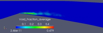

Please note that the pressure is less than 2000 (Pa) at the edge (Paraview image is attached) before beginning the cavitation simulation, therefore I suppose I should have the cavitation in this zone.

The cavitation number and vapor pressure are absolute pressures. So, if you want to use a , the outlet gauge pressure for a given cavitation number is given by, , wherewith .
In the figure that you attach you are showing the gauge pressure, not the absolute pressure. The lower pressure is -58500 [Pa] wherewith the absolute pressure is
I think that this is the problem in your model. I'm using CS 4.0
