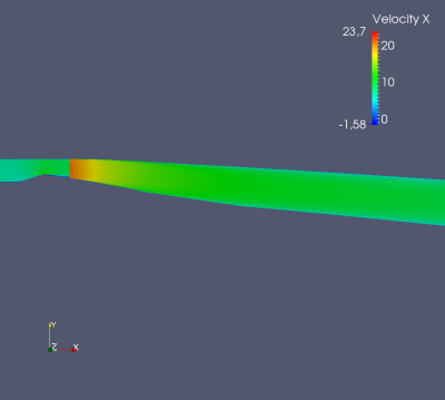

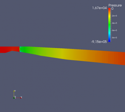

I am using Code_Saturne V.4.0.4 and my goal is to determine the cavitation aspect in the case of a venturi. For simplifying the problem I decided at first, to use a 2D geometry.
I have run my case without cavitation effect for 90000 iterations, I have observed some bad joining and/or bad mesh (paraview pictures are attached), however the simulation have been finished, the pressure and velocity are converged and the results are pretty good.
Then, I made use of this case for a cavitation simulation, so I applied the restart option in GUI and run another case from 90000th iteration where cavitation effect is activated (icavit = 1 in parameters subroutine).
The calculation started without problem, nevertheless I get the following error output after 2 iterations:
