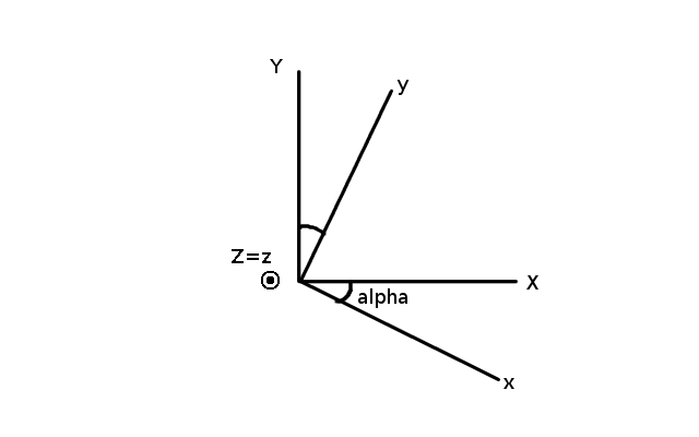

Example 2: head losses along a direction at 45 degrees
Necessary, we shall use here a 3x3 tensor to impose head losses at an angle $ alpha = 45^{o} $ with respect to x and y direction of the computation frame. Namely, resistance is set along components x by cku1 and y by cku2
Orthogonal reference frame sketch
In the present example, it is chosen to set a head loss representing friction along X and to model a vane in Y direction by setting ck1 = 0 .
