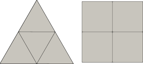

Basic face refinement templates

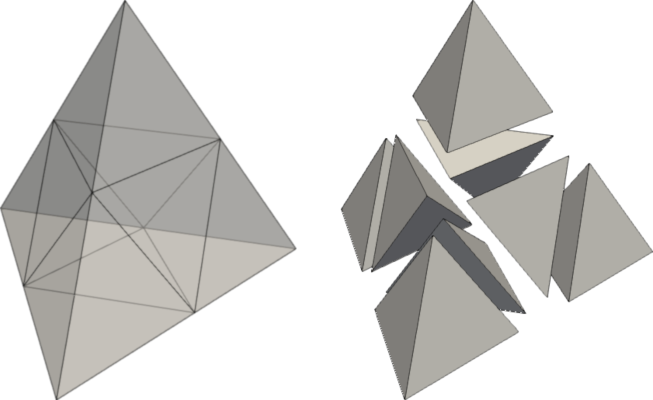

Basic tetrahedron refinement template and subcells

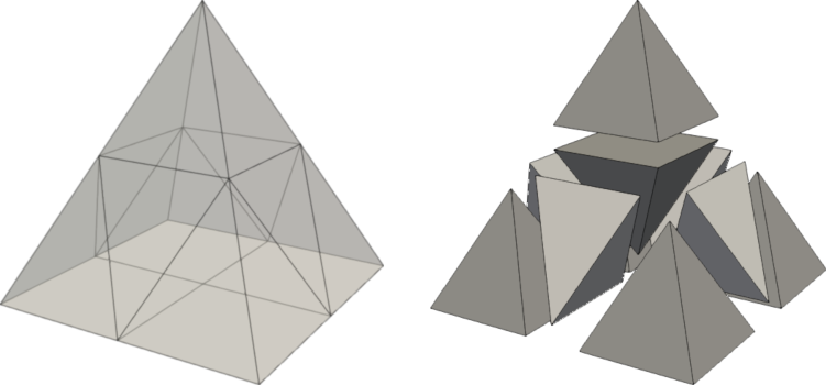

Basic pyramid refinement template and subcells

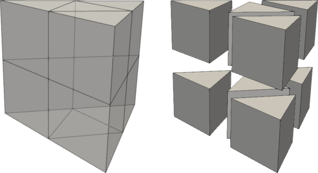

Basic prism refinement template and subcells

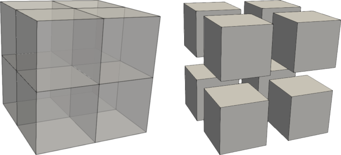

Basic hexahedron refinement template and subcells

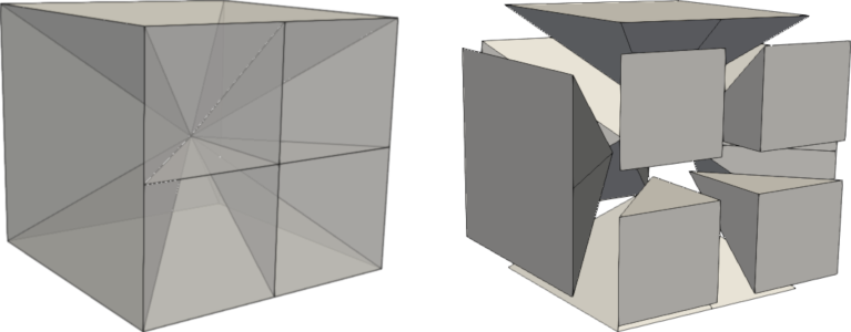

Polyhedron refinement and subcells example

Accepted keys and values:
  • "triangle_subdivision"
    • "triangle" (default)
    • "quadrangle"
