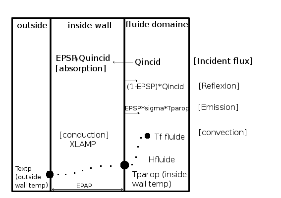

The radiative boundary condition is based on the calculation of a new wall temperature. This temperature is computed with a thermal flux balance:
Therefore :
code_saturne the flux is positive when it is oriented from inside to outside.| Body | Emissivity |
