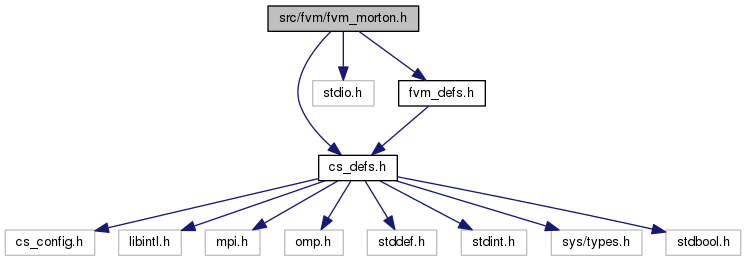

Include dependency graph for fvm_morton.h:
