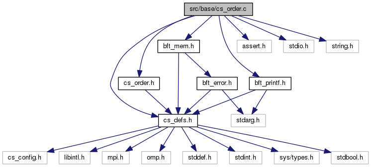

#include "cs_order.h"
Include dependency graph for cs_order.c:
