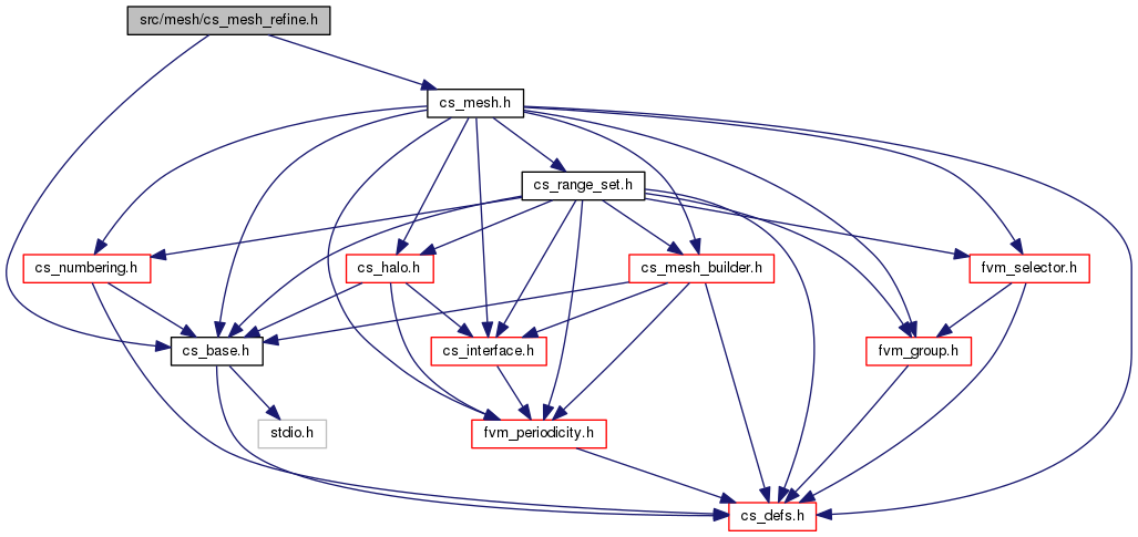

Include dependency graph for cs_mesh_refine.h:
