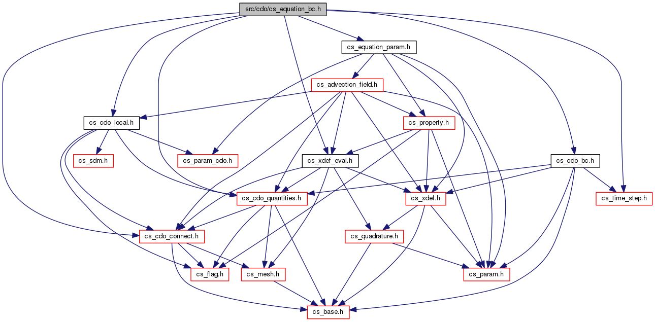

#include "cs_cdo_bc.h"#include "cs_cdo_connect.h"#include "cs_xdef_eval.h"#include "cs_cdo_quantities.h"#include "cs_cdo_local.h"#include "cs_equation_param.h"#include "cs_time_step.h"
