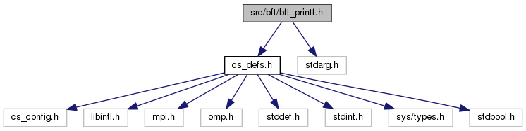

Include dependency graph for bft_printf.h:
