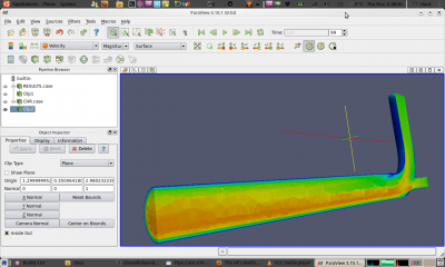

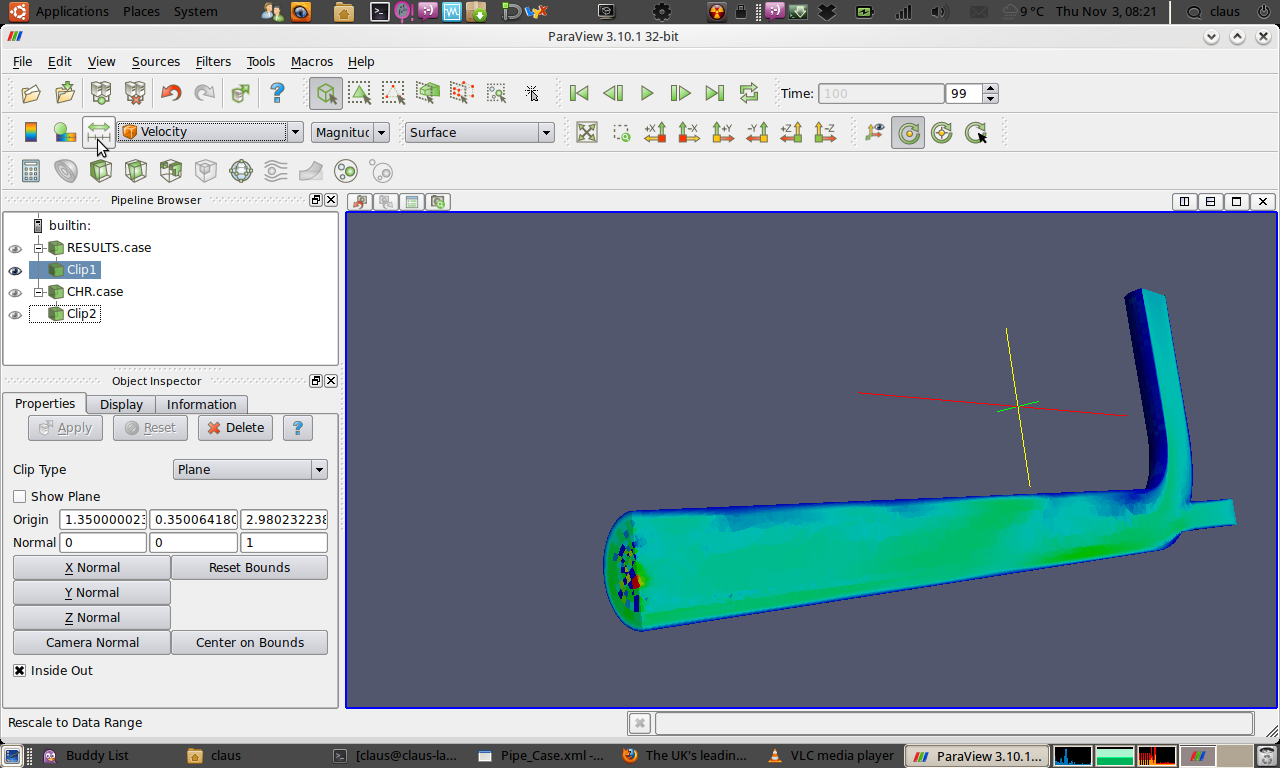

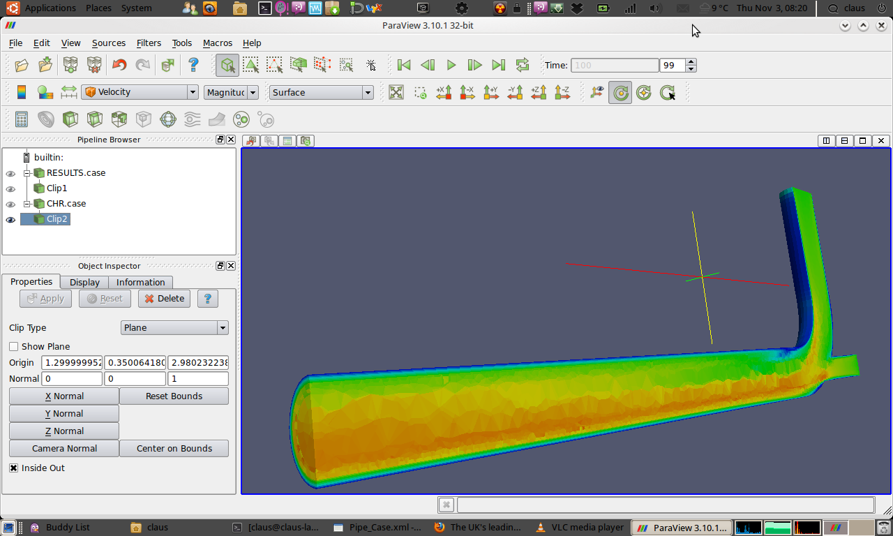

On 2.0.3 the simulations ends well with nice convergence. SEEMINGLY so does the 2.1 version, but upon post-processing, strange localised hot-spots appear on the outlet cells.
I've attached explanatory screenshots and 'listing' files.

I have compared slices of the velocity profile (with Integrate Variables amongst others) and they are nearly identical in all of the pipe, however, in 2.1 the hotspots appear on the outlet for pressure, temp and velocity.

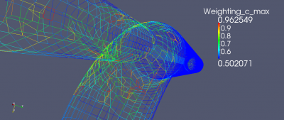

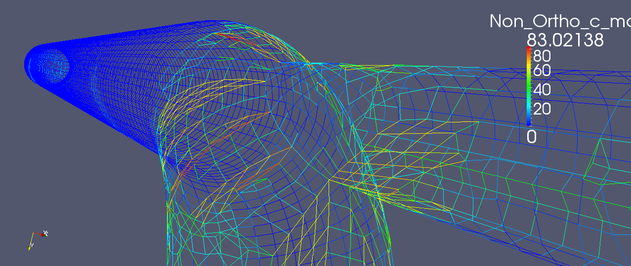

Your mesh have bad quality criteria (see attached). The ideal "Weigh" is 0.5 (see "ipond" in the user guide p:32 for more details) and the ideal "non ortho" (represents the angle IFJ) is 0° (the worst being 90°).
I think the mesh quality is the reason of the bad results (for 2.1 and 2.0 versions).
