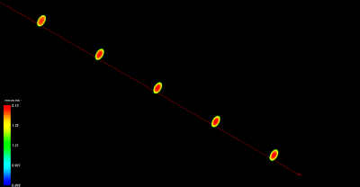

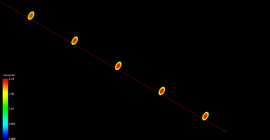

I send you a link to a new calculation. The velocity at the outlet seems OK but I have some excessive values (in the listing look at Umax which should not be higher than 2.09 and dissipation which is too high). Moreover, the calculation seems to diverge at the very beginning but finally it calms down. I don't understand this behavior. I hope you will have all the files needed, here's the link with the password "alexis" :
http://dl.free.fr/vm8fC5o7Y
I attach two pictures with this which are 10 cross sections regularly spaced (the first one from x=0 to x=1 and the second from x=1 to x=2). They represent the contours of U-velocity colored by velocity magnitude. The planes number 2 and 3 are not regular : the number 2 shows a too high velocity in the center of the pipe and the number 3 an offset velocity contour . What do you think of this? I am sure that the method of gradient calculation has an real impact on the result. Maybe you could advise me the proper one for the mesh I send you (which is not a really good one I know but it's for beginning simulations, a hexa mesh may be better...)
Alexis
