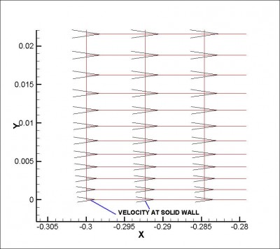

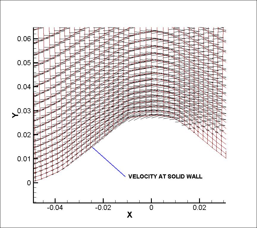

Post by Debashis Basu »
I am attaching some plots of velocity to show my problem.  How come I am getting a velocity at y=0 ?

Mickael Hassanaly
Re: Applying no slip boundary condition for walls in Code Saturne
Post by Mickael Hassanaly »
What you get is due to the fact that velocity value is calculated at the center of the cell.
To get the profile you wish, the only solution is to make a really refined mesh at the wall.
Best regards
Mickaël
