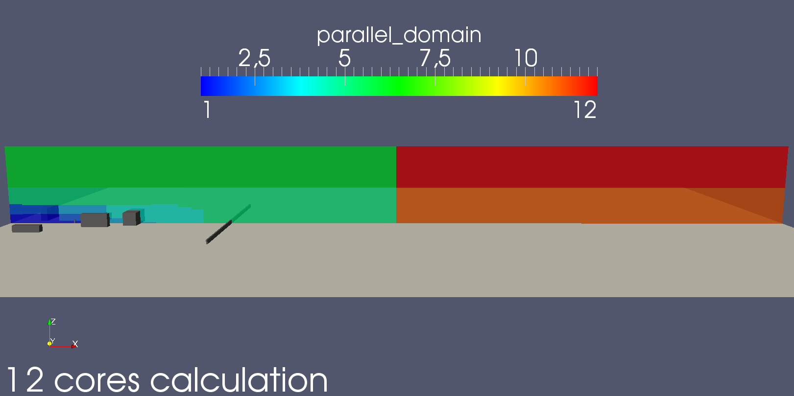

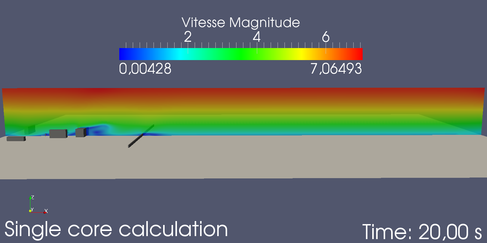

Nicolas Merigoux
Re: Convergence issues when running in parallel
Thank you Yvan for this remark. That was a mistake I didn't noticed yet. As a consequence, I put the line with the temperature definition in the first loop on cells (just after the wind velocity definition), deleted this last loop and ran the case again.
Unfortunately I still got the same weird velocity distribution.
You'll find attached a picture of what I'm trying to simulate. This is the wind profile after 20 s (for the calculation on a single core and on 12 cores). The profile is not totally initialized yet but it gives a good idea of what I should obtain. I also put a slice of the domain decomposition for the parallel run.
Anyway, thank you for this first advice. I hope my pictures will help finding a solution.
Nicolas
Nicolas
