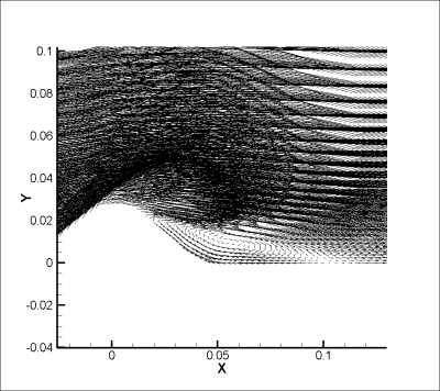

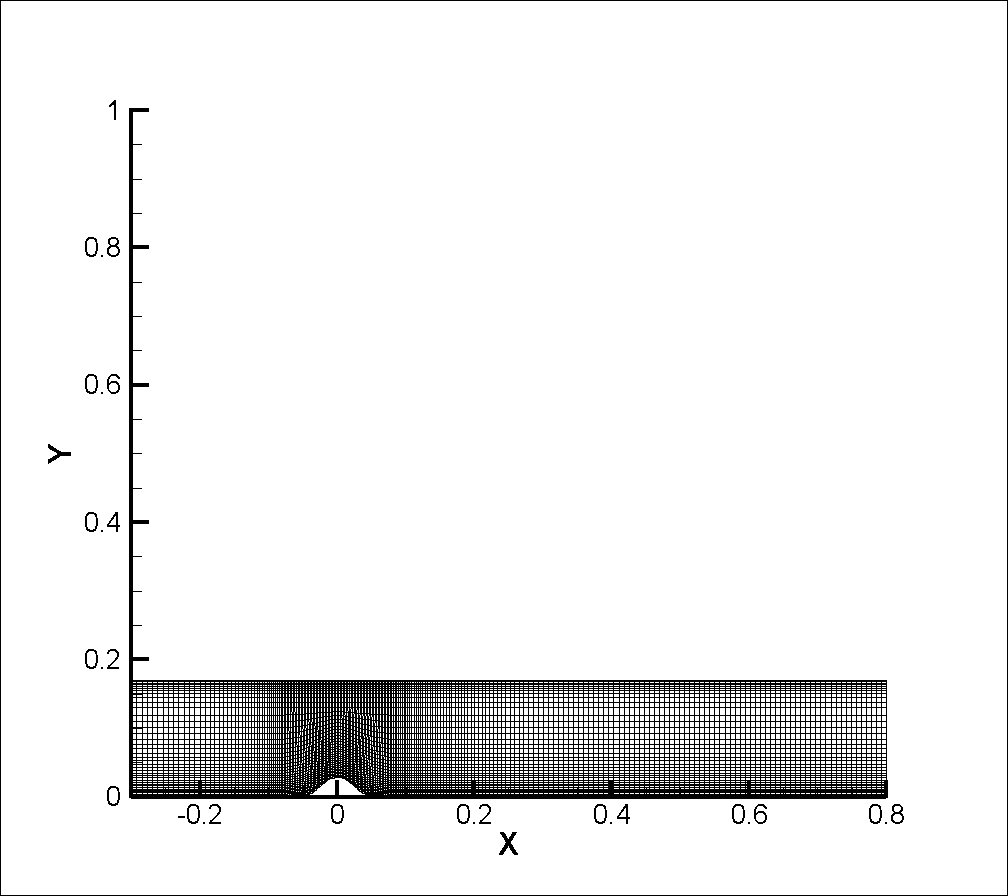

I have simulated flow over a hill. Essentially a 2-D hump.
I have attached some figures for velocity vectors as well.
However, I also want to plot velocity versus y at certaion locations along the x-axis.
Kindly let me know how I can plot it.
