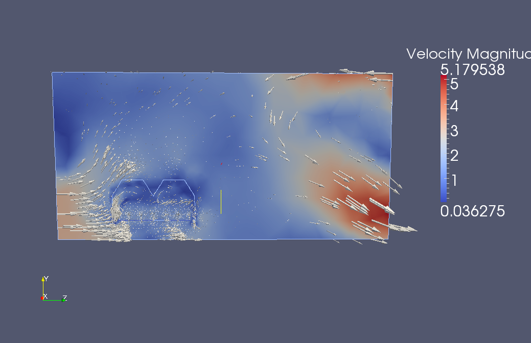

I have now another little problem when running the calculation, as it is possible to see on the picture attached, there is a great recirculation of air from the outlet, which leads to stop the calculations after more iterations. I have tried putting a initial velocity put it doesn't help much. What can solve this?
Damien CHARRERON
My problem came effectively from the surfbo variable.
Damien CHARRERON

This is a know problem - it is very difficult to simulate an inlet-outlet correctly - .
To reduce/correct this problem:
-you must have a layer of hexahedron (or prisms) on your output/input (maybe it's already the case)
-you can try to move your outlet and inlet away from your obstacle (enlarge your calculation domain)
-you can try to change the boundary condition for the velocity by imposing du/dn = 0 (disable the switch du/dn = 0, if flumas>0 (outlet) and u = 0 else (outlet transformed into an inlet))
JF
