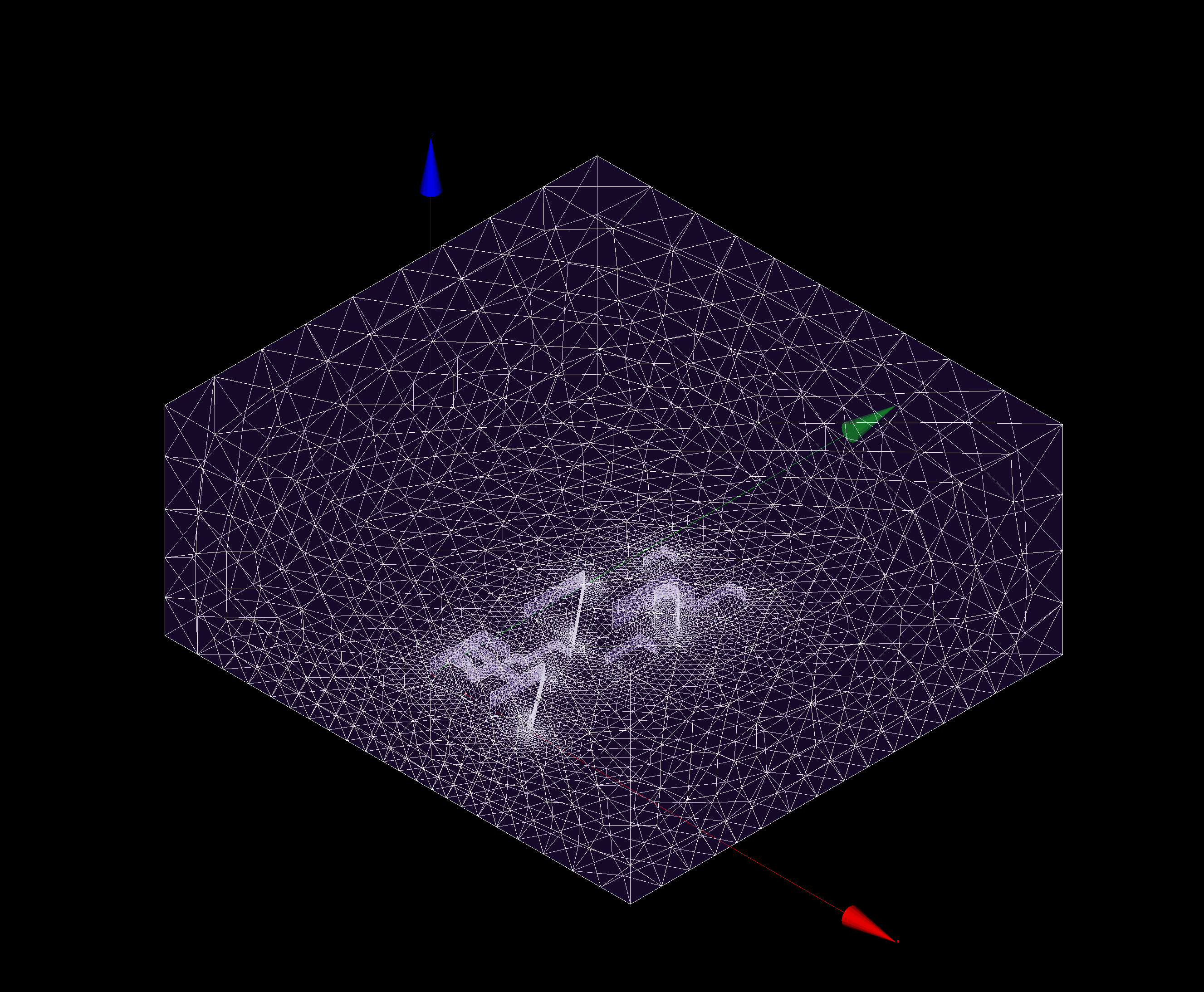

Hi all,
I am running an atmospheric simulation, but it stops every time when it reaches around 360 time steps (time step is 1s in my case), due to this problem:
Symmetric Gauss-Seidel [Velocity]: divergence after 1 iterations:
initial residual: -nan; current residual: -nan
Symmetric Gauss-Seidel: error (divergence) solving for Velocity
I have changed different Gradient reconstruction type, but all Gauss options have this same error. Do you know how to fix it? I attached my run.log and a picture of the mesh. Thanks for your help!
Sophie
Symmetric Gauss-Seidel error
- run_solver.log
- (119.12 KiB) Downloaded 1688 times
- Posts: 4290
Re: Symmetric Gauss-Seidel error
You could increase the logging and postprocessing frequency to get more info on field values when the code starts preventing backflow at the outlet, and a bit before the divergence occurs. Running with a debug build may also help detect some error categories earlier.
Note that v7.0 is not maintained anymore, so upgrading to a current version is also recommended.
