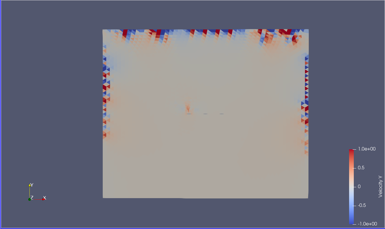

I am running a code_saturne simulation where 3 heating bars are embedded within a still air environnement. The only dynamics of the case is elevating air due to buoyancy at the heating bars.
For the Boundary Conditions, I have imposed a wall at the bottom and I wish to let the three (left, right an top) remaining BC free. Thus, I prescribed a "free inlet/outlet" BC at these boundaries but I seem to encounter numerical stability issues, see screenshot attached.
The chessboard instabilities at the external boundaries appear only when the first buoyancy dynamics reaches these boundaries.
Does anyone know how I can overcome this issue:
1) would reducing the time step (time stepping is time varying at the moment) help? Is there any rule for these BC?
2) would any other BC be more appropriate for this case?
Posts: 4290
Re: Outlet BC and time stepping
It seems you missed the attachment.
In any case, open boundary conditions are the trickiest. Although free inlet/outlet BC's are the correct BC to use, the GUI does not allow defining backflow conditions, so these must sometimes be completed with user-defined functions.
You should check the CFL number, but if you encounter checkerboarding, it is possible that the time step is too small in that area (at least this is what I have sometimes observed). This is possibly related to the fact that the Rhie&Chow filter used in to velocity/pressure coupling has a term proportional to the time step, and loses its efficiency where the CFL is very small.
With a screenshot and a few iterations worth of the run_solver.log I might have better suggestions. If all else fails, padding the mesh to move the BC's farther out (so that recirculations occur in the domain, not at boundaries) may also help.

Thank you Yvan for your fast answer and sorry for the missing attachement. I remember adding it to the post, but I certainly did not go all through.
Here is the screenshot at iteration 700, we can see the plume which has formed at the left heating bar (others have been deactivated), and the instability occuring at the boundaries.
I also attach the run_solver.log file. Let me know if I could provide you with any additional useful information.
