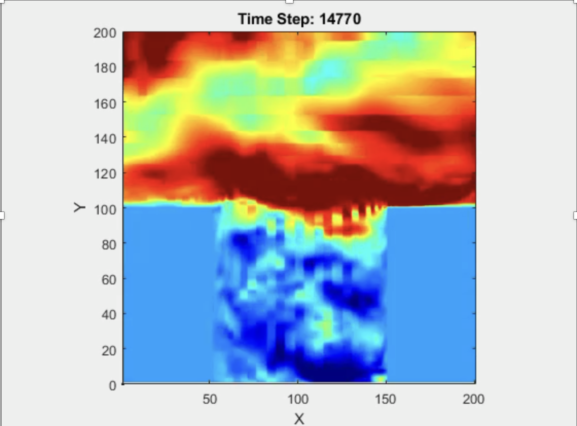

Hi Yvan,
I’ve encountered an issue related to this topic. The mesh cells in the area are 30x50, and I’ve placed 100x100 monitoring points with "activate interpolation" and "one probe per cell" enabled. However, the instantaneous results from the monitoring points appear discontinuous, as shown in the attached velocity results.
It seems the interpolation method being used is based on a gradient-based first-order Taylor expansion, and I suspect this might be the cause of the discontinuities. Is there any method or available code to implement a higher-order interpolation technique that could help improve the continuity of the results?
Ximeng
Ximeng
- Posts: 4290
Re: Automatic change in monitoring point
Yes, the interpolation is based on a 1s-order Taylor expansion. There is currently no better option. The interpolation is actually designed so that a user could pass their own interpolation function, but no such function is available.
One solution would be to use cell to vertex interpolation than vertex to point interpolation, but although this is feasible in a specific user context, it is difficult to handle in an optimized manner (i.e. avoiding extra computation or memory use) without prior knowledge of the fields to interpolate, as this can require a cell to vertex interpolation using all cells associated with the probes.
